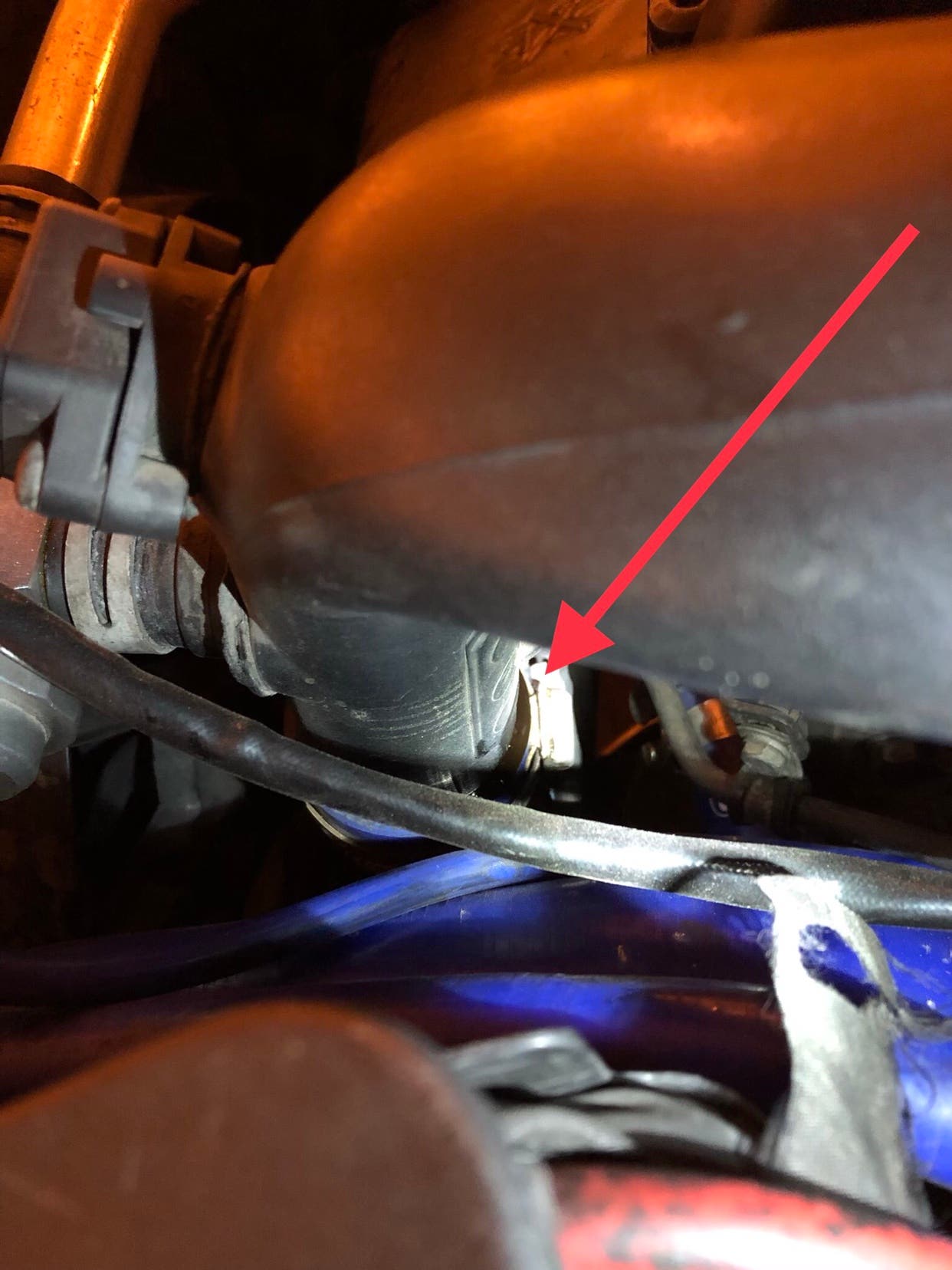

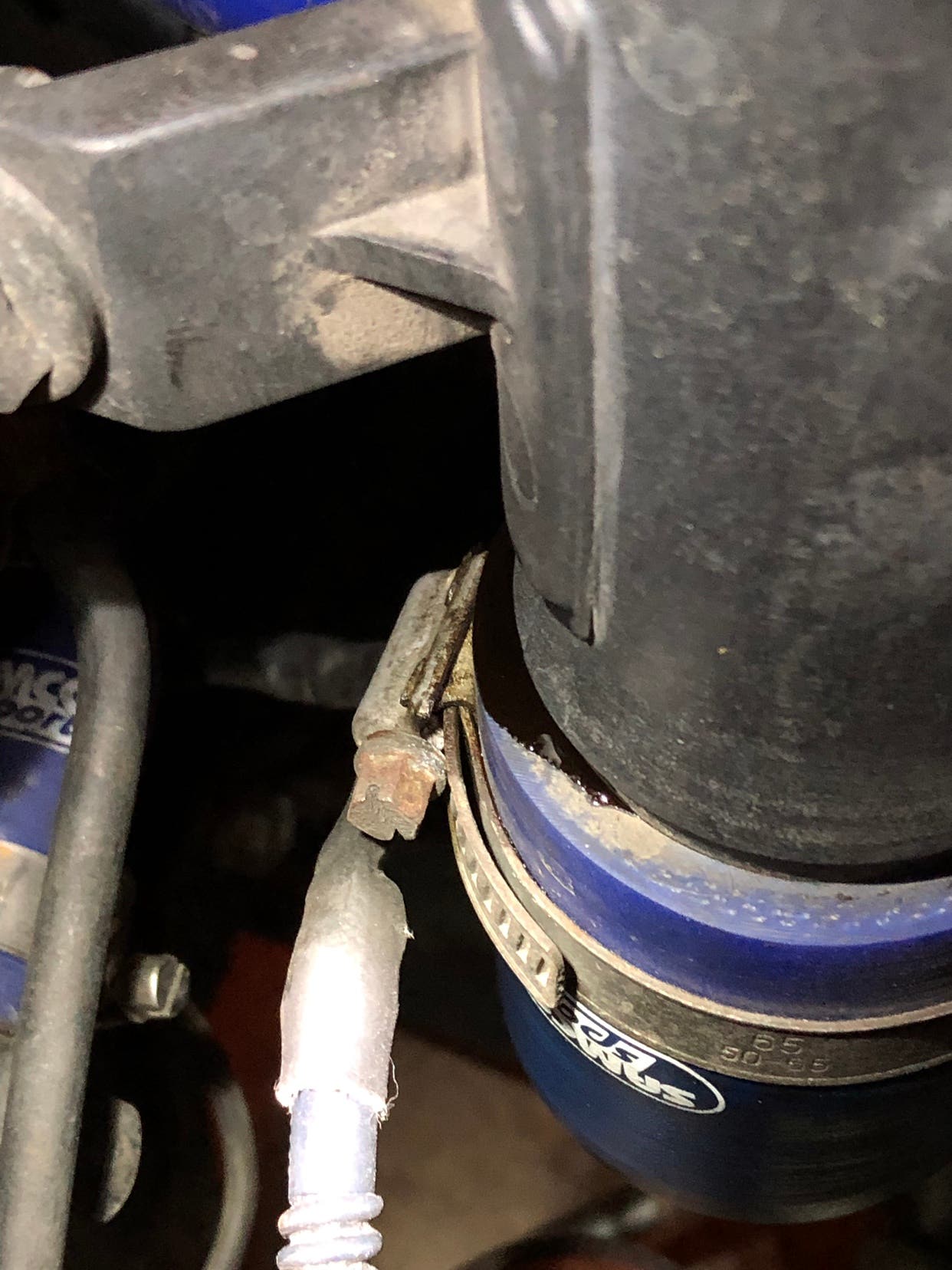

I just realised recently there is oil coming out between the joint of the charge pipe and the silicone pipe after the intercooler.
Is it normal? Oil is leaking? Where are the possible locations? Thanks.

A small amount of oil in the charge air pipes is normal, but an excessive amount is not. Your turbo is probably leaking oil. It can leak past the seals and into the airstream if parts are worn Silicone hoses aren't generally compatible with oil, so you may want to get that fixed sooner than later. Those Samco hoses aren't cheap!
