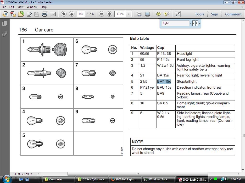

Can anyone for sure identify what bulbs this car takes in the rear.
I just put in new bulbs and I am getting rear brake light failure. I used rockauto parts picker to get PHILIPS 12498LL (12498LLB2) Brake Light Bulbs.
In the image below which of the upper two bulbs is considered the brake light bulb, and what is the other one called? Backup / Reverse Lamp Bulb right?
Phillips Site:
Tail light P21/5W 12499LLB2, P21/5WLLB2
Stop light P21/5W 12499LLB2, P21/5WLLB2
Rear sidemarker P21/5W 12499LLB2, P21/5WLLB2
Stop light P21W 12498LLB2, P21WLLB2
Back up light P21W 12498LLB2, P21WLLB2
Confused here because phillips site is showing too many bulbs.
