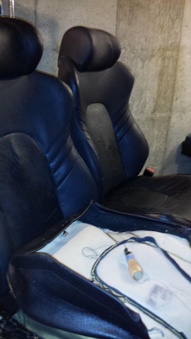

I'm sitting in my basement refurbishing a set of aero seats for my SPG right now. :)
You cannot swap skins from an aero seat to a normal seat. There are bolster supports that would have to welded on. In order to make it work. I was considering this, but have decided to add memory functionality to the passenger seat and a relay that allows them to operate when the interior lights are on. I take my kids to school in my car and need them to fold. If you don't often have backseat passengers in your vert, just bolt them in.

Here's a writeup I put together last summer when I installed 9k aero seats in my c900. I modified the original c900 frames to accept the 9k aero pads and skins. Worked great, and now I can flip them forward.
http://www.saablink.net/forum/2015290-post145.htm
You can install the 9k aero seats right into the c900 if you have electric seats. But the 9k seats were not designed to flip forward. Most people just move them as far forward as possible to get in the back, but that wasn't enough for me. If you have access to a MIG welder, it only takes a short amount of time to modify the seats.

I made mine foldable too, including the lumbar support.
If you know your way with a grinder/cutter and welding machine you have the seats modified in an afternoon. If you just move the extra supports over and don't care about electric seats, than it's even easier. (I only kept my seat electric, the passenger side is manual)
