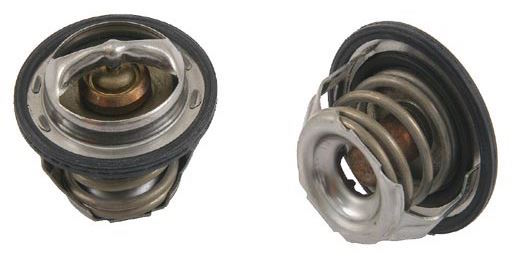

I need to change the thermostat in my 2003 9-3. I can't seem to find it.
The repair guy I can use is out of town til next Thurs and noone else up here will work on it. Would like to change myself if possible.
I already have the part, just need to know how to get to it.
thanks

It is pretty easy to get to once you find it. A couple more notes -
If you stand by the drivers side fender and look down, you'll see the housing - in front of the overflow tank, at the end of the cyl. head and underneath a few hoses and wires. I believe it's held in by two 10 mm bolts.
When you take the old one out, pay close attention to which side is up and which side is down :D.
When you put the new one in, be very careful about not knocking the new seal off. It's easy to do since you need to work your way past the hoses and wires that are in the way.

Hi, I just replaced my thermostat. Do I need to turn the thermostat or just put it there and use the housing to seal it? I was turning the thermostat so long and wonder why it didn't loose, then realized the housing is on the edge of thermostat. I see some people can move the housing on the side, and mine barely move.
My coolant temperature around 176 and little below the half way mark some time. Did I do it wrong?
To remove the third bolt is not hard at all, but I have no way to clean the surface of the housing, unless remove those hose.
