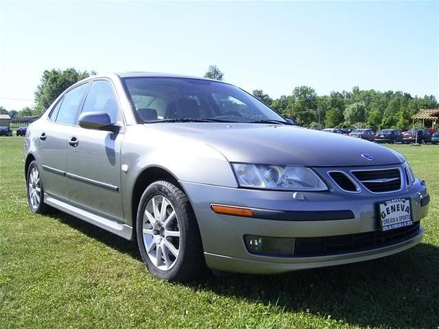

Hey guys, this may be a dumb question but how do the headlight washers work and does the car in the picture below have them? It looks like it does but how the heck would I know, I don't even know how they work. I imagine that they blast a jet of windshield washer fluid on the lights but not sure.

thanks for the response. That is very useful information. did you have a chance to look at the picture? Does this car have them?

Yes it does. This car has the 04> washers. The 03 versions were hidden below a plastic cover and popped up when operated.
