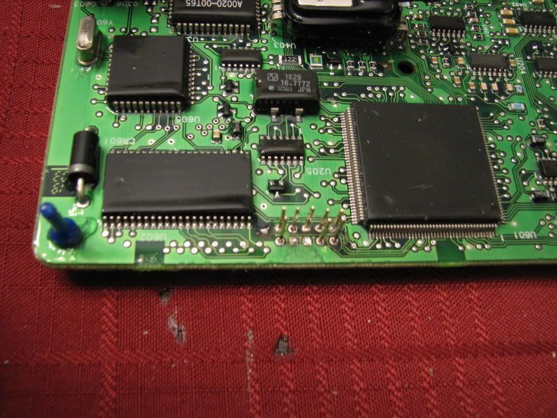

So, all your parts have arrived and now you need to install your pin headers into your ECU.
The ECU in a 9-5 is located behind the firewall, under the plastic shield. It IS possible to remove the ECU without removing the aquarium cover. You simply bend back the plastic housing (this is on RH side of car – passengers side in the US) There is a large black plastic/rubber cover, remove the 4 (10mm I believe) nuts to expose the ECU, then you have two more 10mm nuts holding the ECU in. Use a magnet so you don’t lose the nuts – if they fall, you can usually get them by knocking the passengers kick panel/carpet (INSIDE the car).
Use these pictures to help you install the pin headers after you have removed the board from the metal case: [courtesy of drew on ecuproject.com forums] – there are 10 of them. When I installed my pins, if you go in the exact center of the solder, the pins will actually GO THROUGH the board – this helps with stability – if you push them too far in, it’s quite simple to melt the solder again and pull them back out slightly. If you have access to ecuproject forums, the post where I got these pictures from is located here
