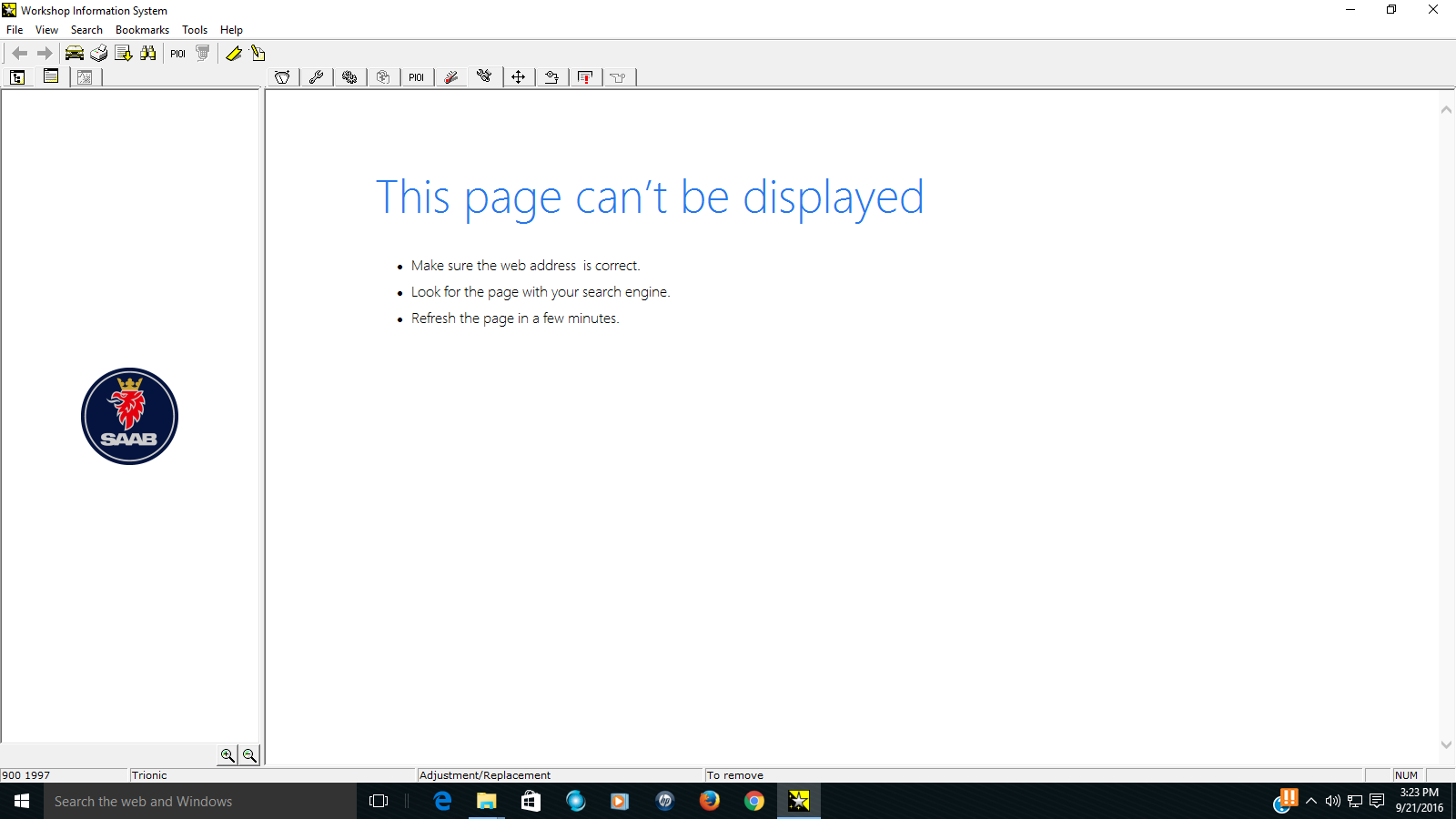

Some Issues With WIS
This new WIS has begun to manifest some interesting issues.
Two days ago I got this when attempting to open it, many, many times:
I rebooted and the issue apparently resolved.
This morning, when I tried to open it, I got the "Please wait while Windows configures Workshop Information System" so the program appears to be reinstalling itself.
So, I am uninstalling this and going back to the cactuz version, which appears to be much more stable. It does not have NG 900, but at least I don't have to reboot to use it, or go through the too long re-installation process if rebooting does not work.
I had a similar issue, where I had to reinstall the WIS, and it was showing some interesting errors. I believe that this was caused by the most recent windows 10 update. I have not had any problems with it since I reinstalled the WIS after the update.
