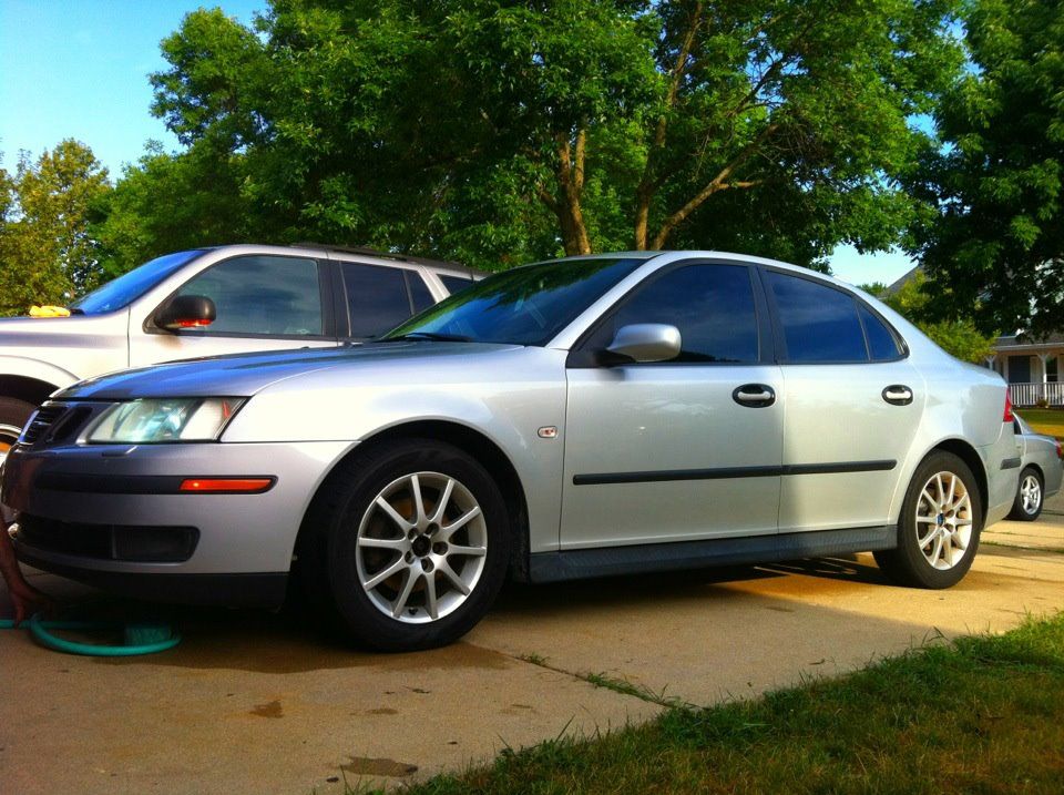

I figured I would make a build thread since I'm planning on going bankrupt with this car. For what it's worth, its an 03 5 speed linear, bought at 72k miles for $4700 in june. Completely stock when I bought it, nothing done to it whatsoever. I have big plans for the car and have already started, so stay tuned and lets see how long it'll take me to realize how much time and money I spent on this POS I dearly love lol
How she sat when it was stock aside from the window tints and my attempt at painting the rear bumper skirt. Also did HID's in this pic, but i'll post up on that in a bit :)
I have a LOT of parts for this car already, i'll write a post for each mod/purchase I make in this car. Any questions, feel free to ask. MOAR POWER!!!

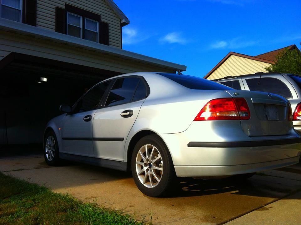

You should start by color coding the side skirts and front lip, so the back doesn't seem out of place. Besides that, good luck!;ol;
362 Posts
Already started with the rear bumper skirt, came out decent for a first timer! WIll do the rest once I finish peeling off the plasti-dip! Thanks for the comment!
