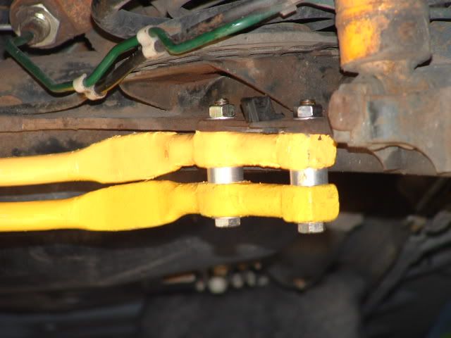

:lol: Courtesy of Big Nev i've joined the double stack rear ARB club, he supplied the extra one all riced up in yellow so I popped mine off and did the same :cheesy:
It is a real easy hit to do, note the slightly bent one :oops: i jacked my car up on the rear beam and bent the ARB in the process.
Close up shot with brake pipes aside for clarity, note my bespoke Aluminium spacers, much lighter than a stack of washers which helps keep unsprung mass to a minimum :lol:
Many thanks to all of you that have done this sooner and shared the idea, I do like cheapo upgrades, if I decide that I need more I will remove one and use it as a template to fabricate my own, I fancy going down the tubular route.

Those are cool spacers! :wink:
How much weight do you figure you saved? :cheesy:
I'll have to take mine off one of these days and see if installed them correctly since I seem to need a lot more space in between them. :eek:
And how about that colour ... you aren't trying to get your Saab to match up with your Cav Vert, are you? :wink: :cheesy:

so what is your impression then ragtop' did you notice a differance as i did :-??
i also see you shied away from welding them together :wink:
12,576 Posts
There is an instant change, as I backed the car out the nearside rear wheel caught a rise in the loose surface out the back, the car noticably tilted over, increasing the ARB loading really does reduce the independance of the rear suspension, this i've found reduces some of the finesse of the ride, but for sure it corners flatter.
I've toyed with the idea of linking them with some sort of bracket though, but this may creak without some sort of bush, I also looked at the Cavalier ARB this ties in the same places along the trailing arm as the 900 but it is also bushed to the torsion beam too, its all food for thought I guess.
i also toyed with this as you know but having had my double stack for a few months now i have desided it is not neccasery

Nice job Raggy.Wish it was that easy to double up the ARB on the 9000's.
I'm working on it at the mo.......but that's for the 9000 forum :cheesy:

Bump for this mod :D
I liked it so much, I'm doing the same with my car. Yellow paint is drying as we speak. Did the front sway bar while I was at it too...
2,059 Posts
Hot tip!
Get 3 stainless hose clamps and clamp the bars together in the middle, and on the sides. I did this, and have been running 4+ months with out ANY problems or noise.
I also drove before and after the clamps, and the difference is well worth the 3 bucks at the hardware store.
