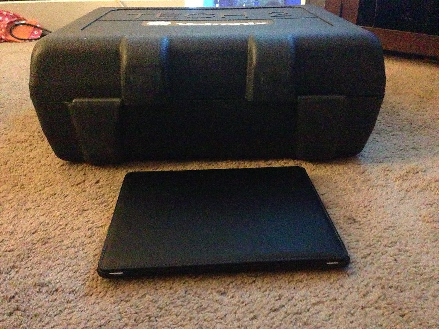

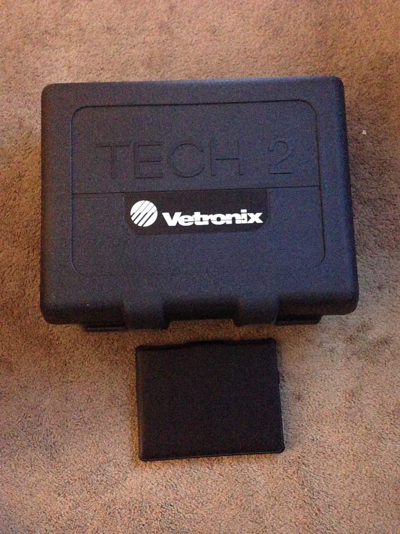

Discussion Starter · #7 ·
Here are pictures comparing it to my ipad
