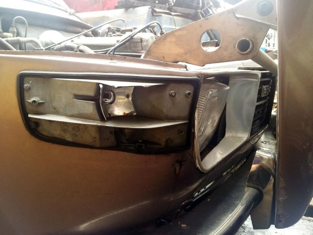

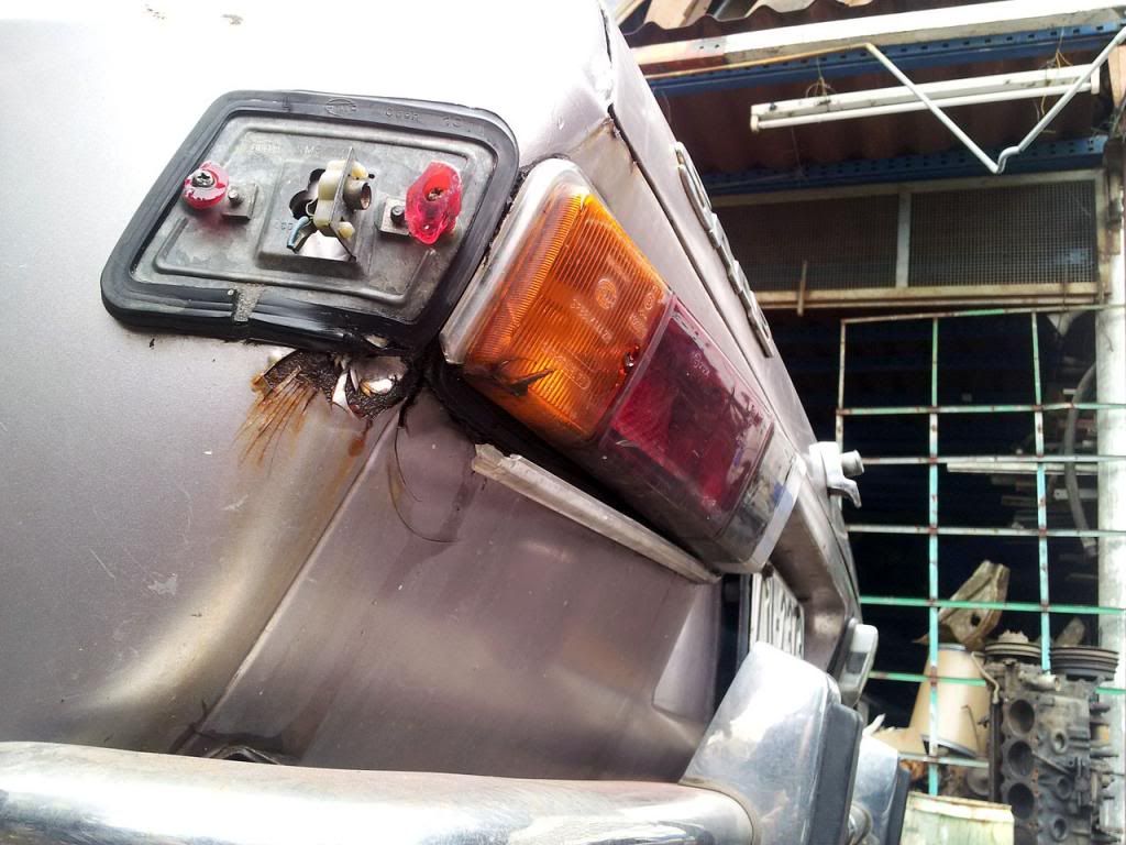

During a last few days, I had come across this beauty in a car junk yard ... the 99!
My friend encourages me to bring her back to life ... which is coincide with my though. However, she is in a vulnerable status. The engine is dead for at least 10 years during her standing to get a direct sunlight and rain ... rust is everywhere.
I am not have much concern on a body restoration as Thai garage can handle that quite well but a trim is my big problem. Where can I source those head lights/back lights/corner lights etc.

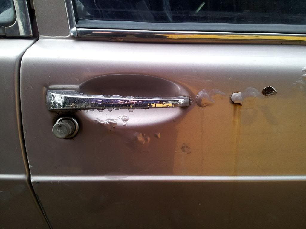

Wow, that would be a huge project. The body looks straight, but there are noticeable bubbles under the paint which could be serious rust issues. Did you check the underside? The windscreen would be tough for you to find and you want to be sure to be careful to save the rubber gasket when you pull the glass out. The Triumph engine is also a concern, but you may be able to get parts for it.
Honest opinion? Find another one! But you may not be able to in your location. If you do take it on, I think a lot of people would be impressed here.

1. For serious rust issue, the garage here has demonstrated a very good job in reviving a similar kind of vintage car. Some body parts may need a replacement with a custom-made steel to replicate the rusty one. I am still waiting on his opinion and estimated cost.

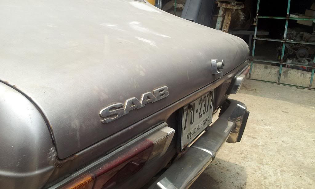

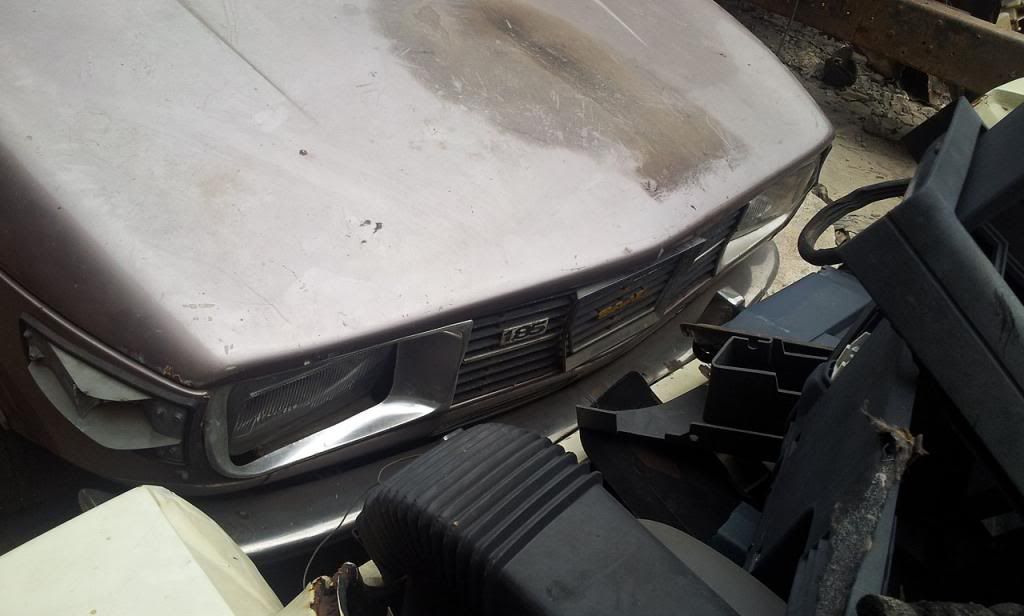

I notice some differences of this 99 with the rest of photos I can find in a google. I am wondering whether this one is a genuine 99 or not. May I ask for your support in clarifying my doubts please?
1. This 99 does not have an 'air scoop' on top of the engine firewall.
2. VIN number of 99069080 indicates that the car was produced in 1971 but the external appearance was similar to those of newer model years.
Front grill and corner light are similar to a 1974 model ...
However, there is a chrome bumper instead of a newer 5 mph bumper

Sorry, I should have followed up with your other questions. I've been interested in the earlier parts myself for my car and I know that in some and most cases you can use earlier or later pieces. I was particularly interested in the earlier pieces because by 1977 and even more so in 1978 things got a bit 'cheap'.
In the US, the rubber bumpers with the steel band showed up as early as 1972, so looking at yours it looks like a 1973 or 1974. If it were earlier it would likely have a thinner, (bakelite?) steering wheel and a different dash. Can you take a picture of the center part of your dash? I'm curious about how that looks. The door sills/plates also look much earlier.
Your early bumpers look in great shape and you could likely polish those up nicely.
The grille set up and side indicators is definitely mid 1970s.
The wheels are from a 900.
1973? But that grille is definitely 1975.
