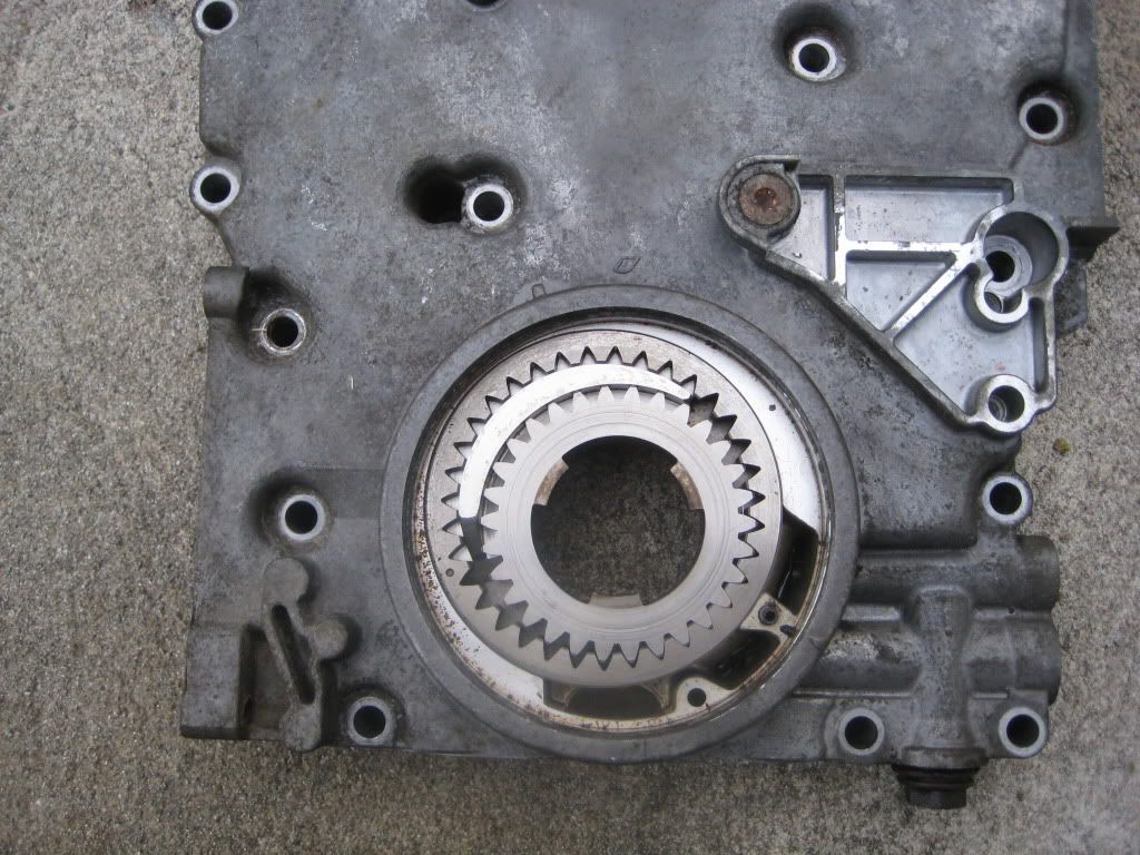

I've read all of Chuck Andrews work, but unfortunately he seems to have halted work on the oil issues lately. He mentioned somebody attempting to put a b234 oil gear set in the b235 housing. I've thought about that at length and I don't think the modification is "slight". The diameter (both inner ring and outer ring) is larger than the b235 counterparts.
Take a look at the b235 gear set in the housing here:
Here is the b234 set:
Here they are side to side:
Notice that the B234 set has material inbetween the inner an outer gear where the gap is the largest. You could machine out the b235 housing to accomodate the outer b234 gear, but how do you add the material in between the two gears? I had thought maybe just machining a small lobe, and bolting it in. You'd have to increase the diameter of the entire housing, then machine the little lobe, and drill and tap holes for the lobe to bolt on to.

I've now had the chance to compare the two oil pumps, housings and covers. No way the B234 pump can be used without serious modifications.
