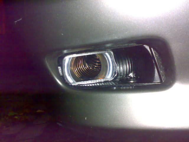

Driving down the motorway I got a stone flick up and smash my right side spot light.
I thought that instead of spending £75 on a new light I'd undertake to do "the spotlight air feed" mod...
So here are the finished pics......
1,816 Posts
Fab up a shield to force all the air through the hose...that should help some more.
2,901 Posts
Yeah that looks pretty good, Like they said you should make the mount a fennel so that all the air gets pushd directly into the tube and you may want to mesh it so a small animal doesnt call it home durring the winter.

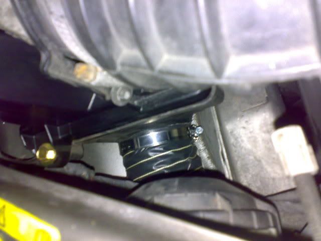

Any pics of how the plumbing runs inside the car?
Also what did you use to make it?
2,515 Posts
So you plumbed it straight into the airbox? ;oops:
Plumbing

i must say nice job=] i did sum what the same but i just ran the hose behind my light just to get a little more cooler air.. nothing forced like yours is, my lights still work. im thinking about trying to run it behind the lower grill. any amount of cooler air works i guess.
