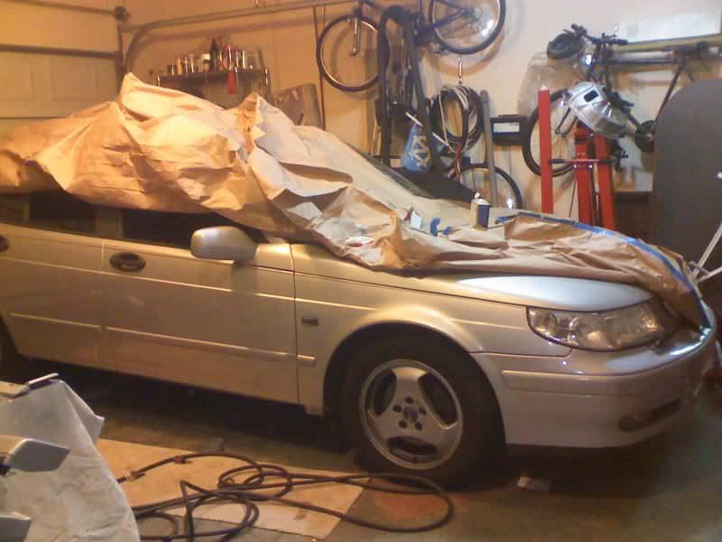

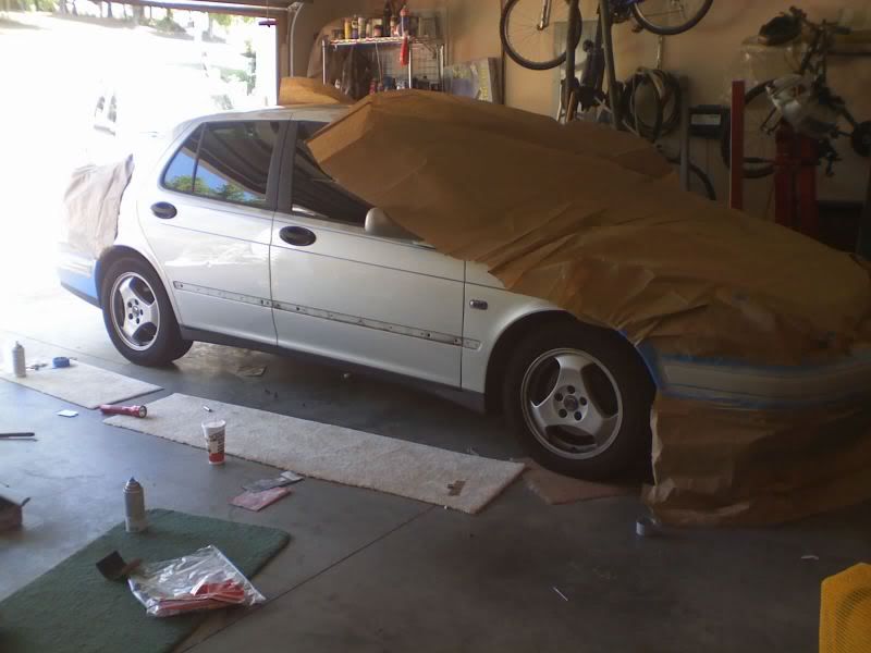

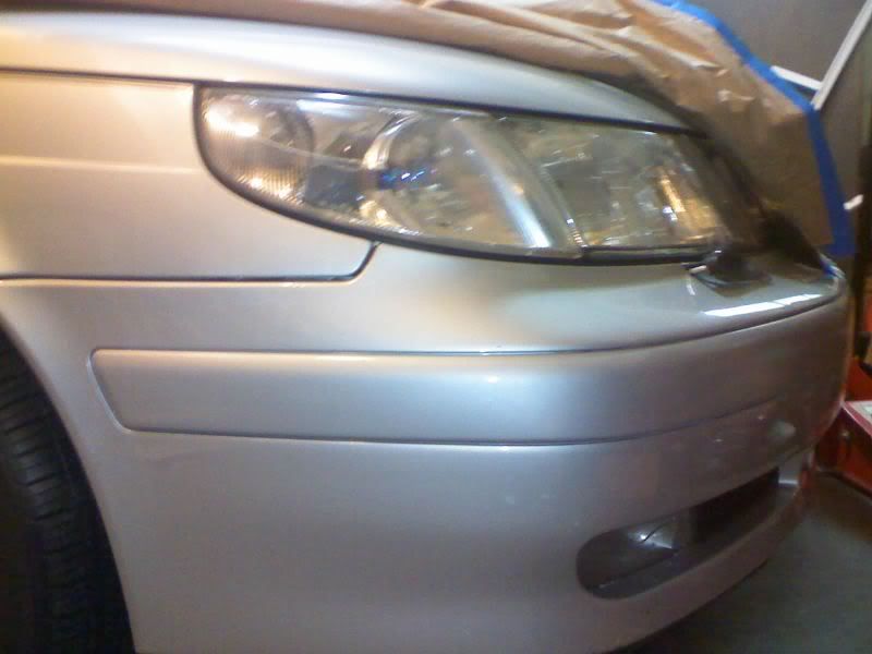

basically what i started with, i dont have any before pics of the car.
then on to this stage
completed pics to come in the morning, its to dark here to get any good ones.

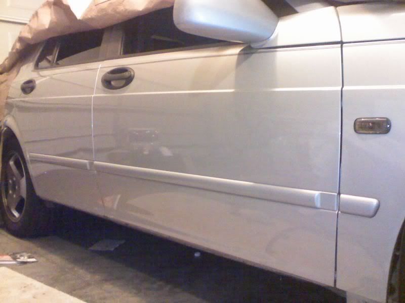

:cool: that looks so much beter than faded black
Definitely and wow what a difference changing the small side repeater makes too :cool:

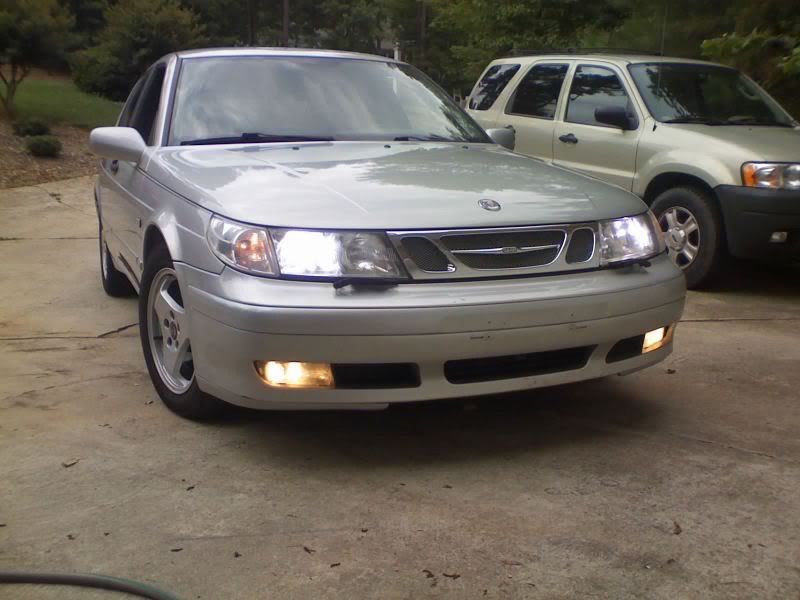

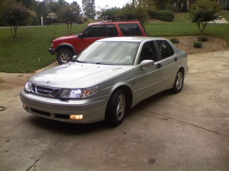

door handles will remain black for the time being, untill i decide i dont like them. the side trim just pops right off, just put a small screw driver behind it and it come off. eventually i will end up repainting the bumpers entirely along with getting an aero lip. but thats a project for another day. here are some more pics from this morning, enjoy

That car looks absolutely years younger - well done!
So how do you prep and paint the plastics?
226 Posts
it really does make a big difference, i prepped using a lot of high to low grit sand paper and a lot of high build primer, plus some filler in spots where the plastic had been dinged up. i used chromabase paint and clear to do the job with flex additive in the clear to make sure it didnt crack when it flexed. i prob have at least around 20+ hours in the project not to mention the hours my frineds put in. its a pain, but WELL worth it!
