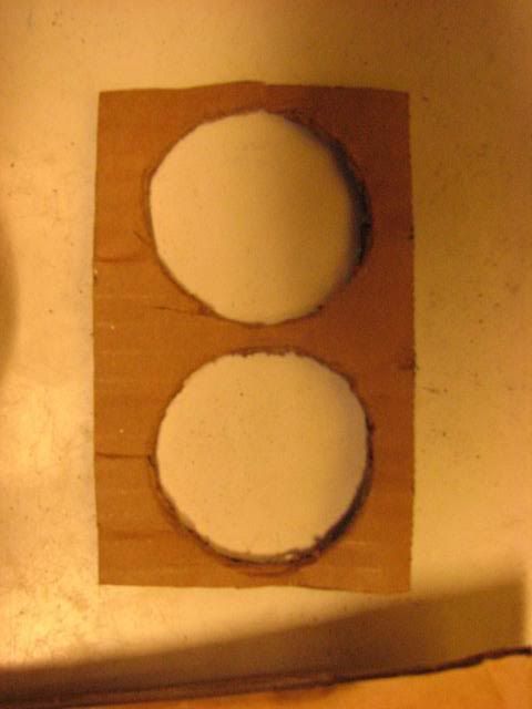

i got oil pressure and temp gauges and was wondering where to mount them and i wanted them to be clean looking, and not flashy up in my face, something subtle. so i sat in the car awhile and thought and heres the idea i came up with and the results.
---by the way, next time, im using a block of wood then using that wood peice to make my fiberglass mold.
first is the location of mounting my custom panel for my gauges (i had to trim the side bars off from the cubby hole for it to fit--
then started with cardboard for the general shaping and size

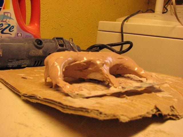

then cut out a peice of aluminum in the shape, then realized ummm i need it to angle up and over a bit so now i had to start forming it up with bondo.

then lot of work forming the right shape and size

sorry for all the pictures but i wanted to show progress of this even though i did go about making this a little wrong. a ton of bondo!!!!!! i didnt thoroughly think the angling part very well before hand. so this is the mock up and i might get a block of wood and start making another one for the fiberglass mold. a guy i know here has seen my progress of this and is offering to buy one off me so im going to consider making more and selling if theres any interest. the way i did it here was a TON of work. it doesnt look like it but it was a PITA!
