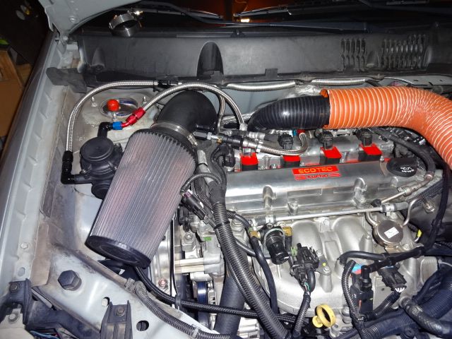

this is the install on my other car bottom left of picture; the seperator is inserted in the rocker return line and then exits to the inlet tube in the stock location, post maf /pre tb so it retains metered air etc. The drain back is to a modified dipstick tube with a check valve so no emptying of the catch can is needed. This is a supercharged Redline of course with the SAAB ecotec LSJ evolution.

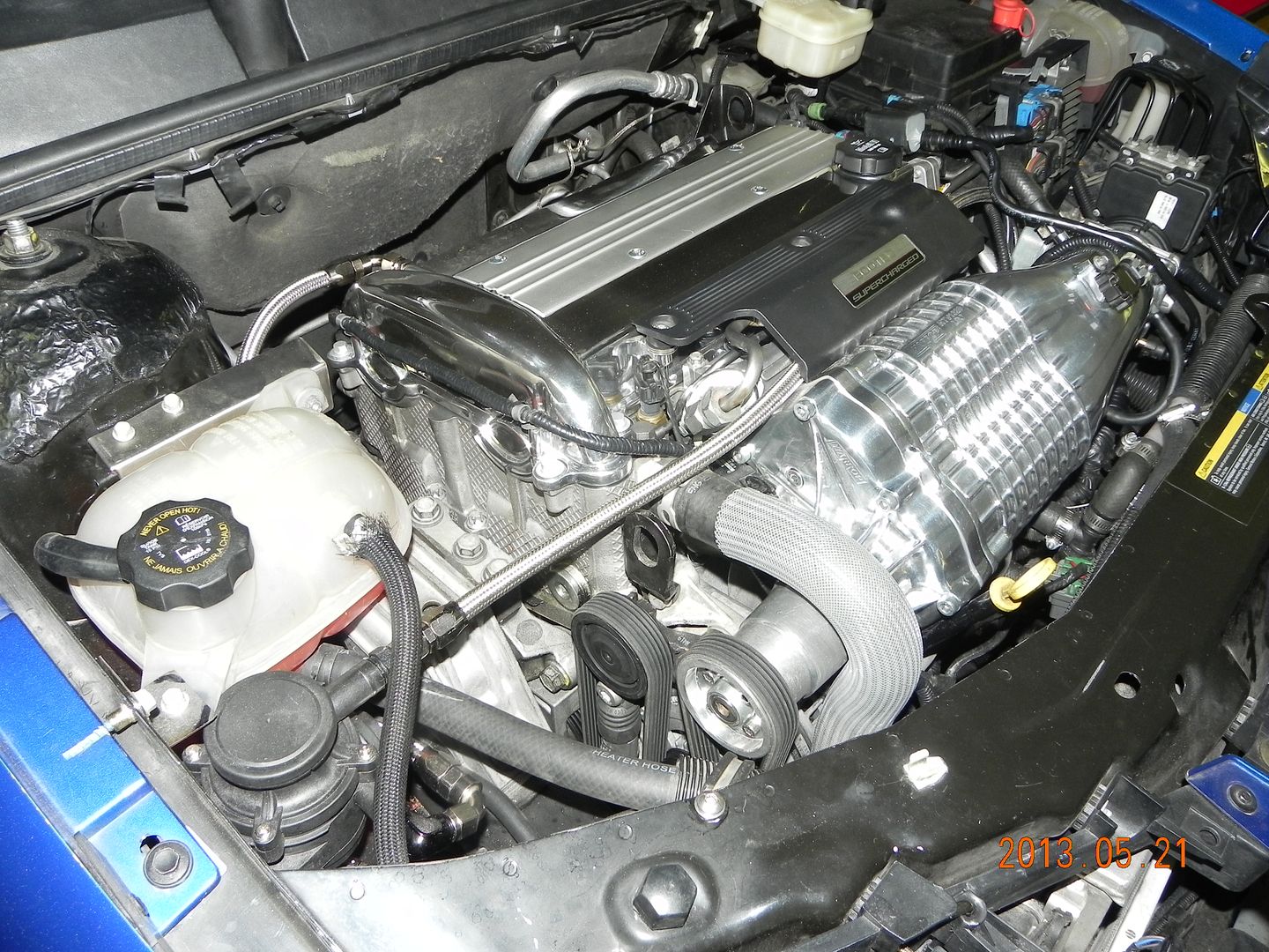

and this is the install on a high hp ZZP upgraded Turbo ecotec in a Cobalt.

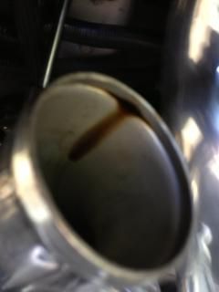

this is oil in the inlet of a stock Sky Turbo

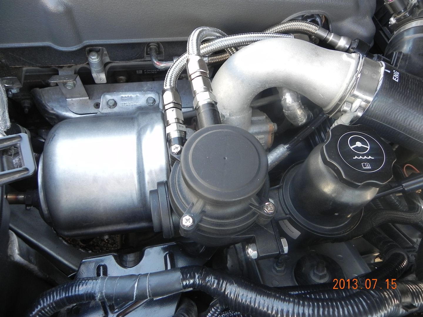

and this is the seperator install on a Sky Turbo. fixes the issue of oil in the inlet.

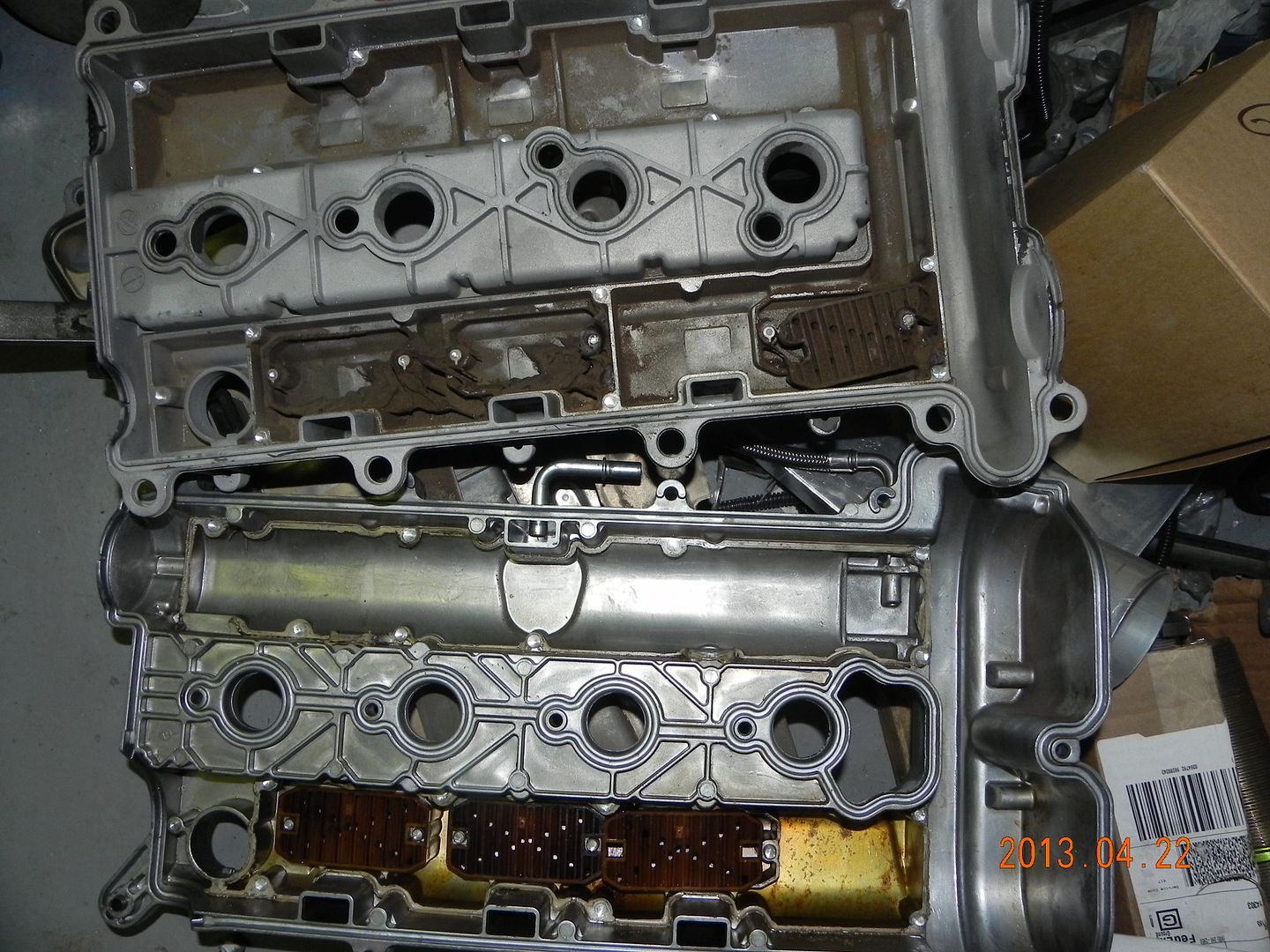

just as an FYI here are two rocker covers. The top one ( mezzanine cover removed) is an LSJ the seperators are damaged from overheating by an idiot powdercoating the cover. caused engine failure) The LSJ 2.0 is a supercharged engine most similar to the 2.0 SAAB motors. The lower one is an LNF 2.0 thats the next generation to LSJ a turbo SAAB based motor, but with direct injection and more sophisticated PCV system that theoretically is always drawing vacuum even under boost.
The LNF has a seperate fresh air inlet with a check valve to to the engine crankcase. The SAAB and the LSJ engines used the same line to vent and to allow fresh air into the crank case.

Point taken
Uthan I was thinking. Find a way to drop the pan.
what i was thinking was this.
my second car a 1959 Morris Oxford blew up ( no pcv, simple windage pipe to atmosphere BITD) from sludge in the oil pan; blocked the pickup.
while the PCV was part of the root cause of the SAAB issues, the condensation and crap carbon is carried around in the oil. The head is alloy, on the 2.3 the block is iron, the 2.0 alloy. The head is probably one of the hottest parts of the engine, the oil circulates carrying all the crap and crunge with it as it designed to, then drops down after doing its job pressurising the crankshaft, getting sheared in the rockers etc, to the coolest part of the engine , the bottom of the oil pan, and there it all condenses. ugh. In minnesota, parked while you warm up, oil pan sitting in a snow bank. Crazy thoughts. it takes at least 25-30 minutes of good running at highway speeds to get the oil up to temperature.
So Uthan, I strongly urge you to rent a warm garage, pay an indie but whatever, drop and clean the pan; its clear that the damage potential is great, but also if there was no PCV upgrade, condensation has been developing way more than you think.
my .02 c.
Thanks qwik, I agree with you. My daily commute is right at that 25 min mark - I always get the engine up to temp on the gauge but I know sometimes it's not getting the oil hot enough. I'd like to see the pan for myself to know the situation, too, sooner rather than later. :eek:
· Registered
790 Posts
Discussion Starter · #19 ·
A follow up question, then
So what was the difference between the MY 2004 and the MY 2003 engines that made the 2003s susceptible and the 2004s seemingly immune to sludge? They're both B235 engines, so was it just the PCV system? Or something else?
Making mental preparations to drop the pan over the next couple of weeks...

6,513 Posts
I am far from expert in these SAAB matters but I think that upgrade #6 to the PCV was standard from 2004 on up... or something like that. Good news on the pan you wont regret it if the motor is still okay before you drop it lol
