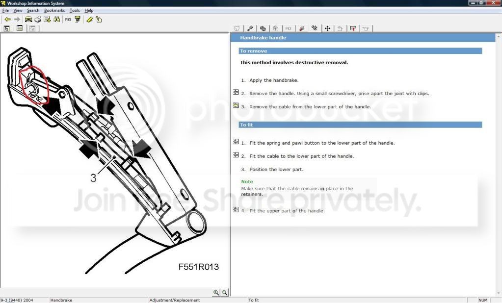

20004 93. I also had a stuck parking brake. It was not frozen, but the handle kept ratcheting upward but would not come back down. In the end I disassembled the e-brake handle to get the car out of the road. Attempting to put the handles back together again I noticed the round spring. I am baffled by where this spring goes in the assembly. I need help. Can someone help explain where the spring belongs?
1,559 Posts
There is a thread out there somewhere with the needed information because I've posted this picture before. I noted the location of the spring in the picture. Good Luck!

I was hoping someone would know where this spring went. I also read on line that the adjustment for the brake is located in the center console behind the change holder. 1/2" turn counter clockwise to release. It seems that the release button/cable was not pulling hard enough to release the mechanism.
1,559 Posts
no problem glad to help! and yes your right about the adjustment behind the change holder

the 90 degree spring
Any help on locating a replacement spring? mine almost took my eye out and i can't find it.
