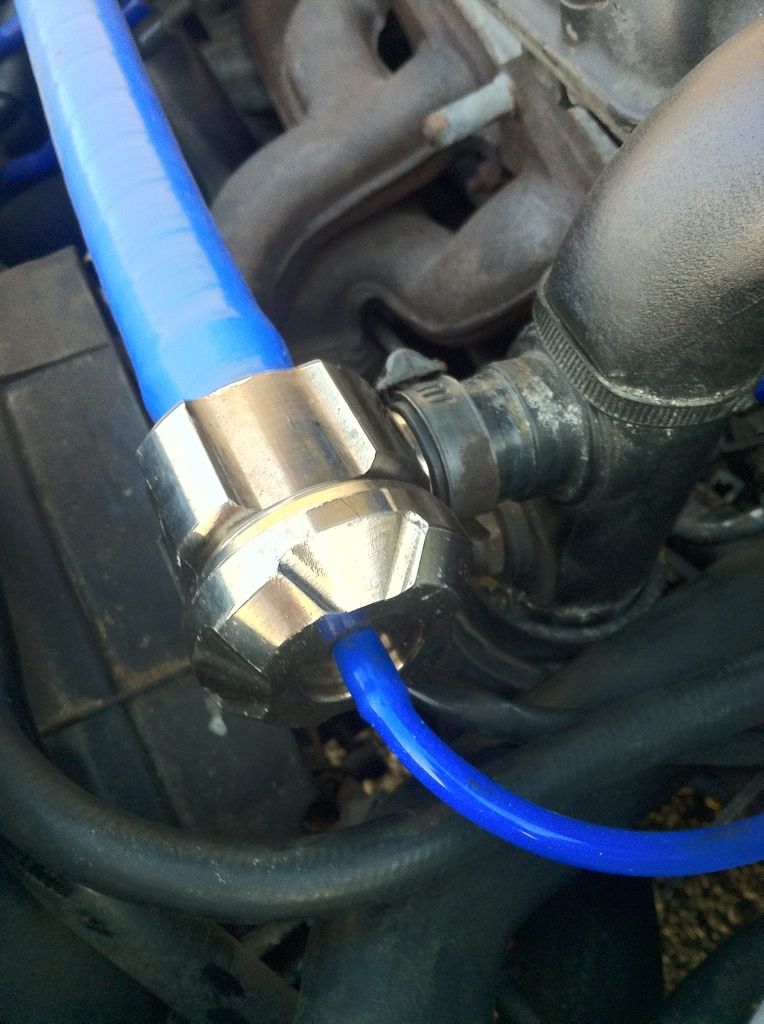

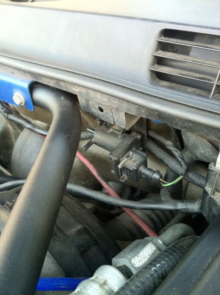

Hyperboost Diverter valve (cleaned today), no vac leaks.. Could the diverter valve itself be bad?
Here is my setup

Swapped in another valve and code is still there
