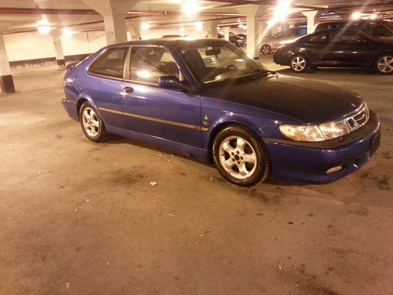

Picked up this bone stock 1999 9-3 LB Viggen last month it was suppose to be my new daily driver and i was planning on keeping it fairly sock but it did not happen, i kept getting used performance parts dropping into my lap lol. I will be updating this thread like my other 9-5 build might this one might not be as active :)
Here are some picture of mods so far and parts i have gotten
How it currently sits
