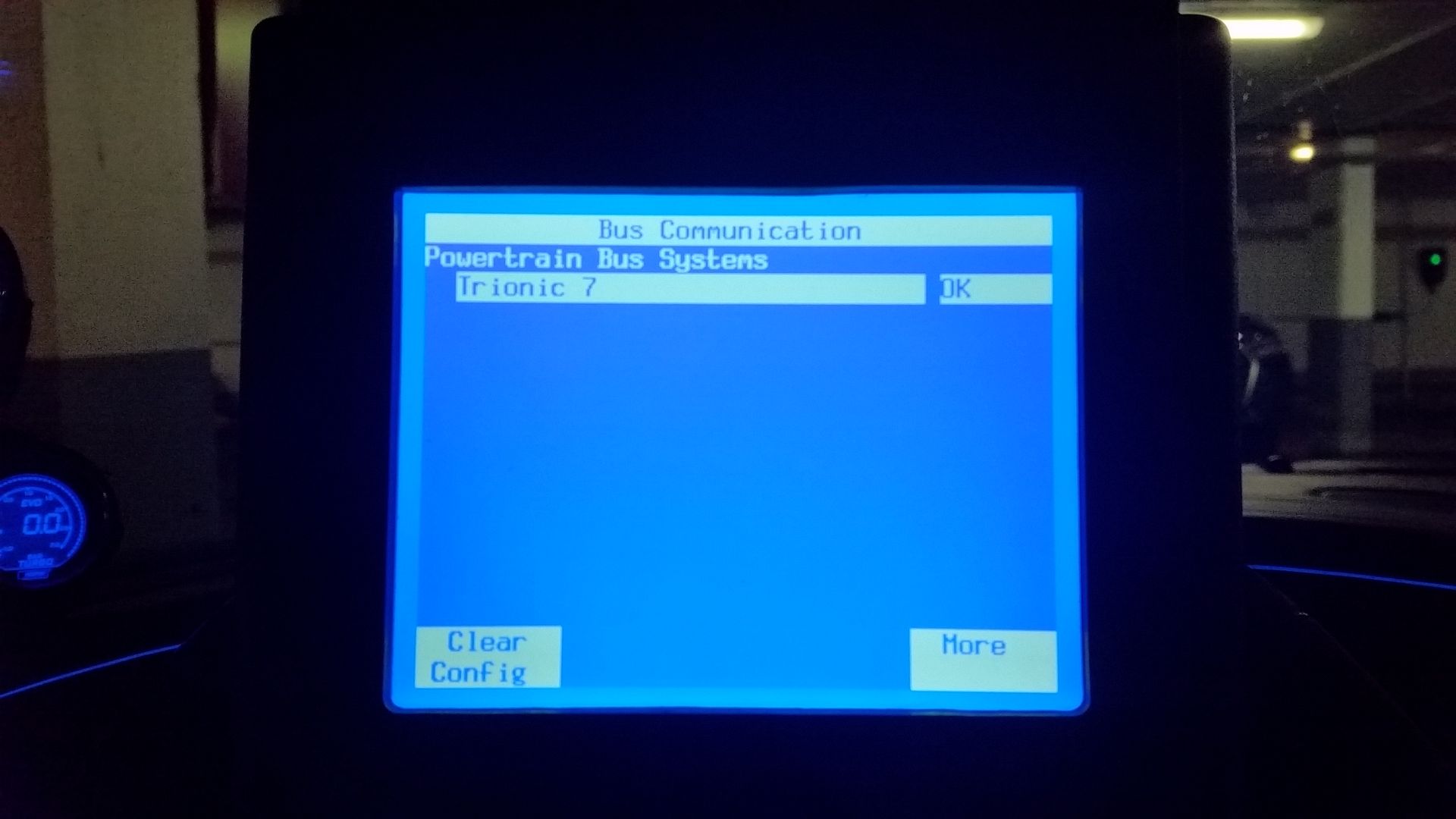

Due to a total communication failure. The undersigned and Maptun have reached an agreement. And because this failure it has come out wrong that Maptun does not tune them self. As it turns out they do not send the tuning to external developers. But carries out programming in there own facilities.
And since we have come to an agreement, I see no reason to have posts according to the subject.
So because our agreement/understanding I have today install the correct programs and it works as it should. Well this was only tested at idle. As I don't take the car out for a test drive until the coming weekend. Due to rain and otherwise bad weather today. But the meteorologists have predicted good weather for the weekend. So then we we take the car for an testdrive then.
