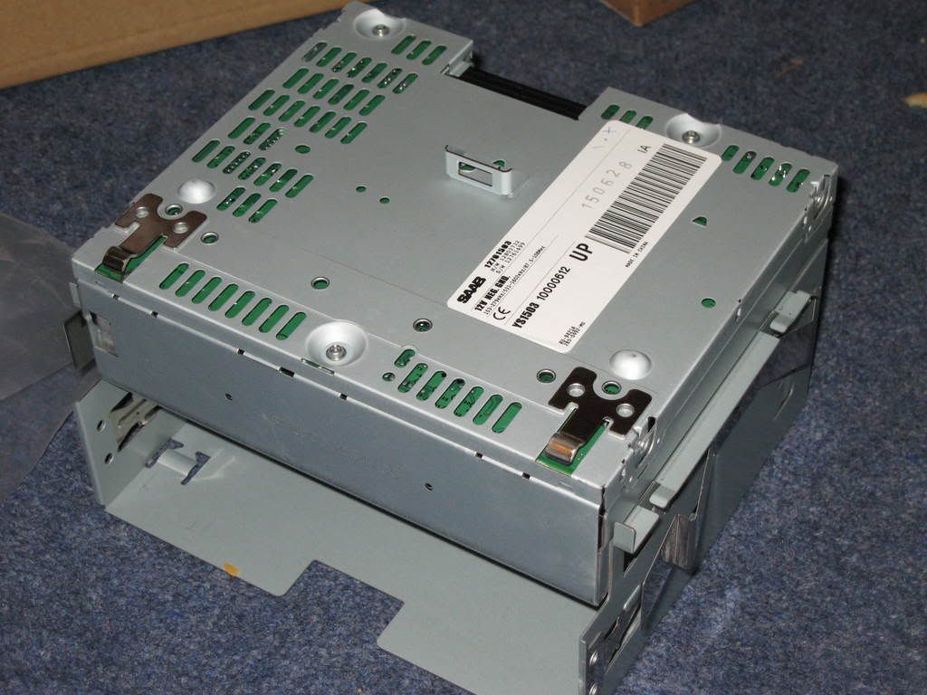

The DVD unit. new. part no:12768494. still need bracket for it.

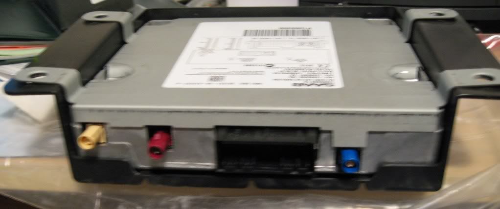

and this. which I was told was the positioning unit for the gps system. part no:12805668 . it mounts under the parcel shelf between the speakers but I am wondering if this is a positioning unit/'cu/pu' at all. It has a blue connection on the back for the GPS antenna, but also a phone connection(bordeaux) and bluetooth antenna connection(beige) on the back also. and on the front it has a sim card slot. is this the gps processing unit and phone unit all in one? heres some more picks of it:
Back, with coloured connectors.

I dont know if my shark fin contains the gps antenna or not yet, I also need to get the bracket for the dvd unit, and the cable to connect it up. any thoughts on the 'positioning unit' is it what I thought I bought? many thanks.

phone unit with sim card reader...:cool:
if you've got infotainment manual look at pge 43..
9,177 Posts
i'm guessing the gps signal is routed through the phone unit to the gps system
description i gave is how it's described in the manual..
nav system components are listed in the manual as 1)sid 2)dvd unit 3)shark fin 4)control panel 5)Steering wheel controls...

2,716 Posts
Article : Electronic unit
PartNo : 12805668
Usage : 2005-2006, 4D
Supplementary Description : Navigation system Telephone
English version
Order Quantity : 1
Taken from EPC

I think you may have struck gold there....
I went out and had a rummage around the back of my car to see what I could find.
DVD player, yep, always knew where that was.
GPS positioning unit - well, I think I've found it, (different location in a convertible - no parcel shelf) behind a panel in the boot, behind the back seat... and it looks similar to your unit, except - no phone sim slot etc. just a blank front end.
I don't have the phone fitted, so that would be right - it would also explain the high cost I'd been quoted to add the phone/bluetooth, as the whole unit would need to be changed.
From what I understand, the sharks fin is just a dummy on the cars without SatNav installed - but you're still well on the way to upgrading for not a lot of dosh.
Keep us posted how this works out.

What you have there is the GPS Positioning unit complete with the inbuilt phone !! You got a cracking deal. I had a quote from Saab to change my positioning unit for the one you have (with sim reader) and the quote for unit alone was £625+VAT !! Well done... Christmas came early for you !
