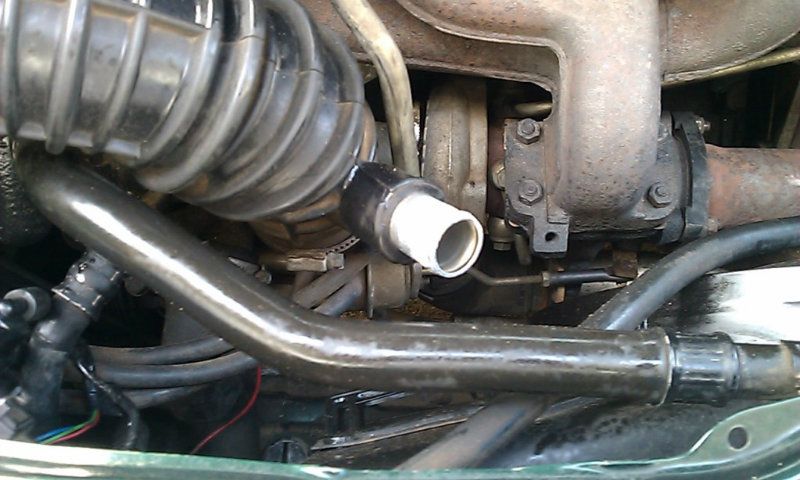

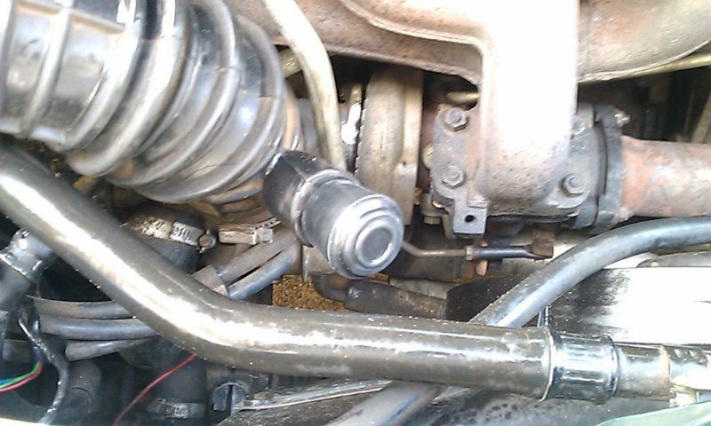

Just in case anyone with a T5 wanted to atmosphere vent, but couldn't come up with something to cap the intake pipe, here's a inexpensive alternative. I found a 1" (25mm) chair leg tip at Home Depot. A pack of four only $2.39. It fit snuggly right over the metal tube.
