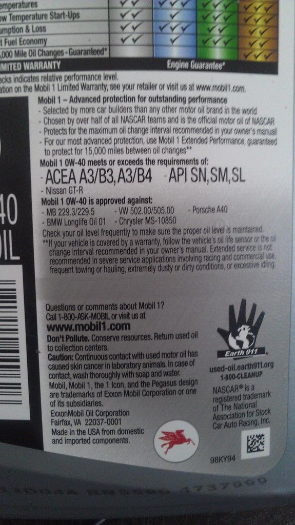

Just did an oil change on my new saab and used the 0w-40 euro formula that most recommend. The GM-LL-A 025 specification has been replaced with Dexos 1, meaning we can technically use any other dexos approved oil including Royal Purple 5w-30. But I looked on the back of the Mobil 1 0w-40 and didn't find a single thing about being GM approved..Does GM not recommend it anymore?

The Mobil 1 website has language that seems to say that it meets GM-LL-A-025 but implies that they didn't pay GM so they can't advertise it on the label.
Mobil 1 0W-40 meets some other good criteria, like BMW LL 01 and ACEA A3/B3 so I like it.
