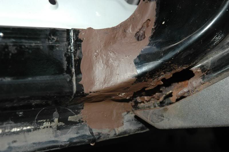

Unfortunately found this in the LH sill:
Slightly alarmed, although I don't think it's structural so will get a bodyshop to weld it up.

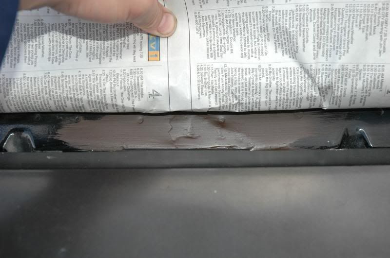

Door bottoms - pass door hasn't got any worse so cleaned it up with Kurust and hammerited them. When I have a mo I will fill and spray it as it's only a small hole.
driver's door not so good! :lol: Again, cleaned it up and hopefully it won't get any worse. Not too worried as I will get a panel welded over it and at least it's under control now.
