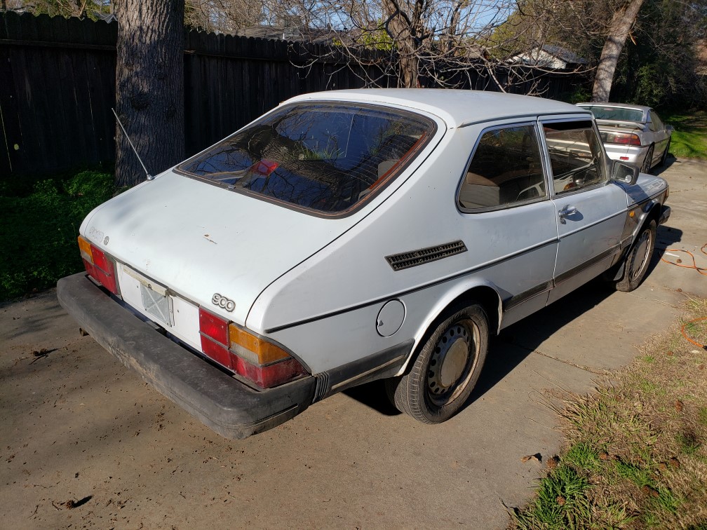

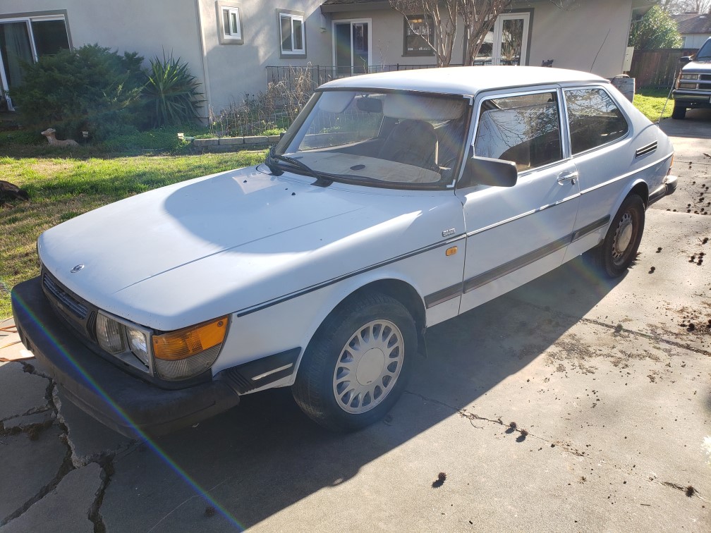

And you're like, "Ah, it's a bit faded but not so bad." But, it's pretty bad.
It's absolutely bonkers to me, but someone actually cut off a damaged fender and delicately welded a new one on. This is basically unheard of on an old 900 IME... I have literally never seen it done. So, while it's ugly it's kinda neat too.

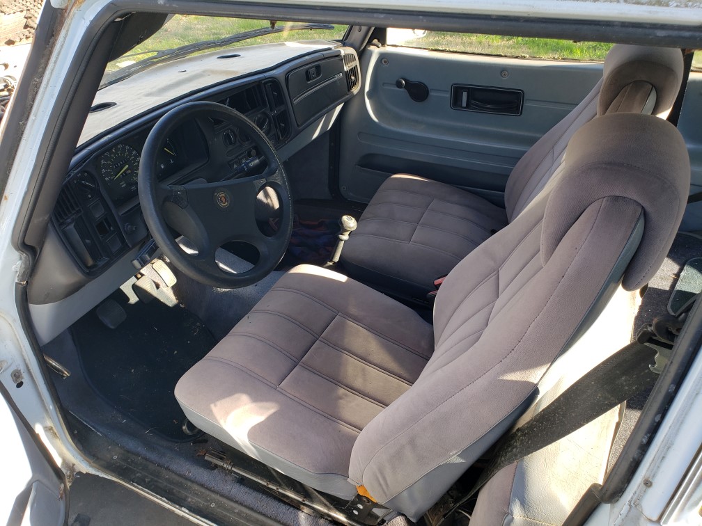

Everything worn and broken, random damage everywhere, and a passenger seat not actually bolted to anything. "I had it removed, I was using it as a truck." Ugh.

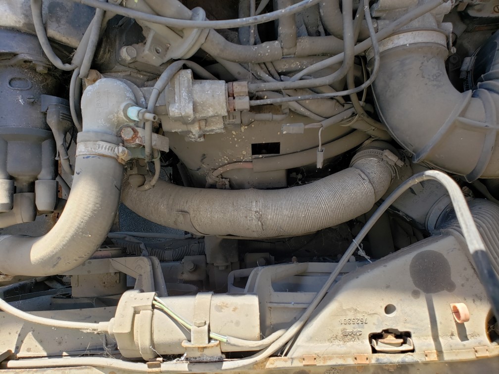

I vacuumed old most of the spiderwebs, so underhood looks like this:
Could be worse?

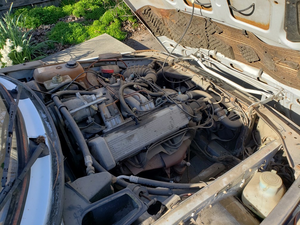

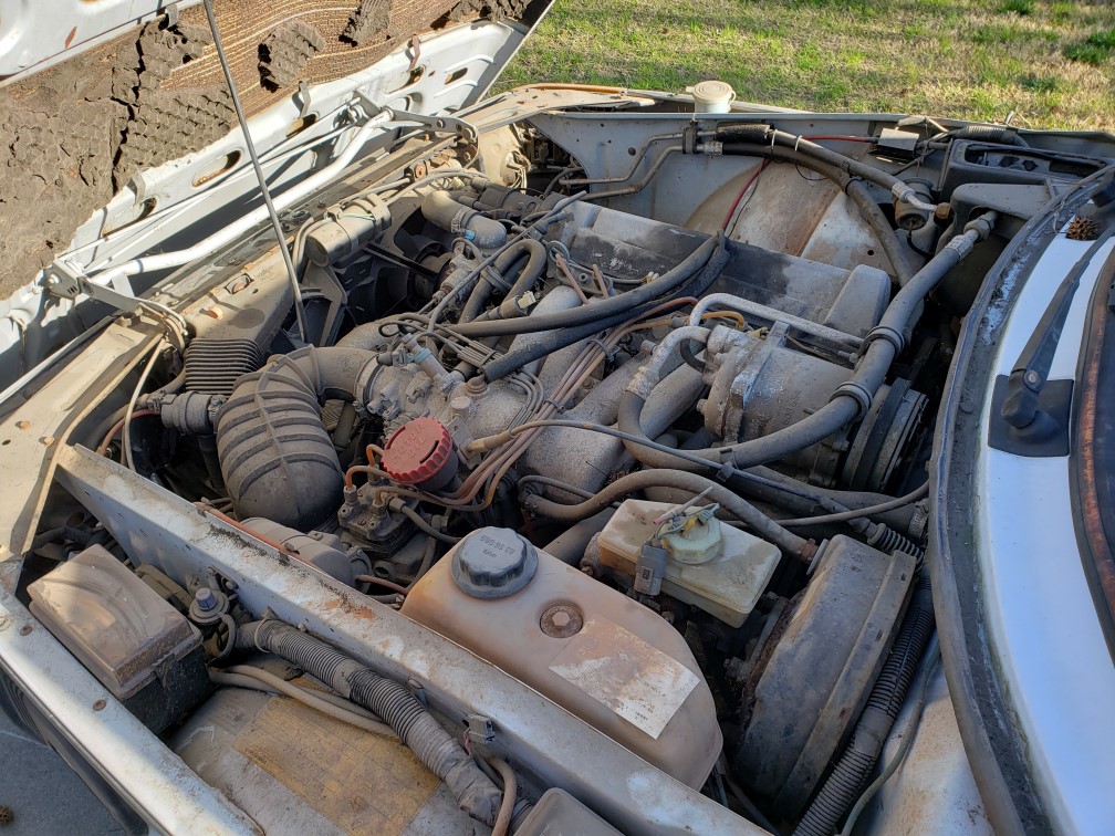

Anyone know what's missing here?
I don't know what happens next. I think I'm gonna pull the head and have it checked out, but probably it's gonna sit for a bit longer... maybe I'll see if I can scare up a 16vNA motor and do a quick swap to get it back on the road.
