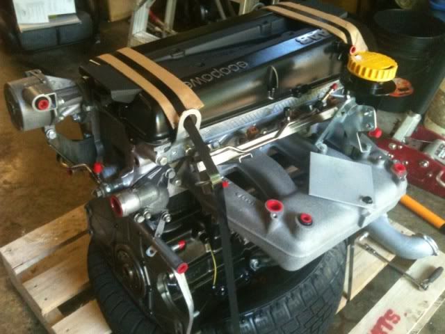

Since this is my daily driver - I could not afford the down time while I fixed my engine (needs bottom end bearings, timing kit and oil pump would be prudent as well) I just needed to do a quick swap and get my car back on the road. The New engine from Goldwing came with a turbo, DIC and Cobra Pipe - nice touch!
made a ghetto engine support brace
lots of steps inbetween that I did not bother to take pics of and the old engine finally came out.

after swapping over the viggen valve cover and a bunch of little stuff, new Thermostat, temp sensor, removing the air pump,new clutch and slave, main seal, all new silicone VAC lines - the new (12K miles) engine ready to go in:
