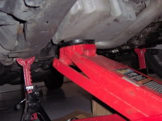

*note the picture shows the floor jack under the engine itself, it is there to support it when doing the passenger motor mount. Do Not Lift Car from there. If unsure where to place jacks or to lift from, look in owners manual for reference.

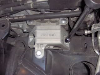

Use flat head screwdriver to remove intake hose behind Mass Airflow Sensor. Unhook secondary airpump hose from the front of the intake box. Use torx bit 25 to remove top part of intake. Once removed take out air filter and remove lower intake box (this is held in by rubber pieces) takes a little manovering to get it out. There underneath the box you will find the motor mount. Now before you pull of the motor mount you will need to support the engine. I placed the floor jack under the engine and lifted very slightly on the oil pan near the torque mount bracket, if you never done this, use a wood piece inbetween the jack and oil pan, this is Only to support the engine not lift it. Once supported you can now remove the bolts, First start with the engine side bolts(there are 2 - 18mm), while removing bolts check to see if the engine is falling down from the mount, if it is, re-adjust the jack for better support. Once the engine is safely supported finish removing the 2 bolts on the mount and remove the 3 - 16mm bolts that are holding it onto the car. Remove mount.

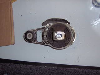

Start by getting the mounts ready. First clean off the parts, you don't need to clean the inside just the outside so the duct tape can stick. Use the surane wrap on one side and fill from the other. The surane wrap will seal but not hold the weight of the urethane. Use the duct tape over the the surane wrap, to prevent it from leaking out the bottom and sides(use at least one layer of duct tape and wrap it tight). Don't worry if you get it on the side or if it leaks a little, it is very easy to clean up on the parts, but lay down card board just in case. Once all of the parts are sealed you can mix the urethane with the hardener, 20 minutes before it really gets tuff to work with, so make sure everything is ready to go before mixing the urethane. Pour urethane in the mounts and let it sit for 24 - 48 hours(I let mine sit for 12 hours it was hard enough). Once dry take duct tape off and use razor to cut off any excess. They should look like this when done.
All three.

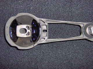

The first picture of the passenger side torque mount with the polyurethane already in it and here are the rest of the mounts, what they look like on the other side where they were filled from.
