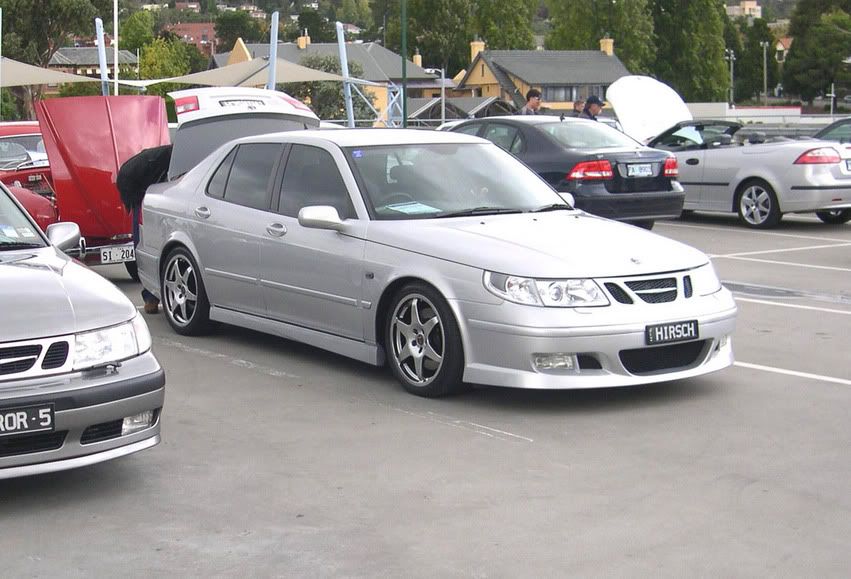

Discussion Starter · #13 ·
aeropilot said:
You never know, even Saab prices may mean they are cheaper than £400.
Saab do sell colour coded door handles from MY06 which will fit these are at a bargain price of £123 each, the mouldings they only sell primed, but there is still problems with the front and rears.
Here is one someone done earlier that inspired the thought.
22,211 Posts
Thats the pic I was looking for, well done :p
4,845 Posts
That is magical, that's what I was looking for too, thanks guys. I'm definately going to be painting my mouldings. Now about handles, can you paint them, or do you have to order them from saab?

Oh man, that looks really good on that black car, I wonder how it'd look on a silver one?
11,030 Posts
But are they chrome? They could be sprayed silver to look chrome, a closer inspection is needed. The black stealth look is killer though. :cool: Somebody from the board should do that. ;)
