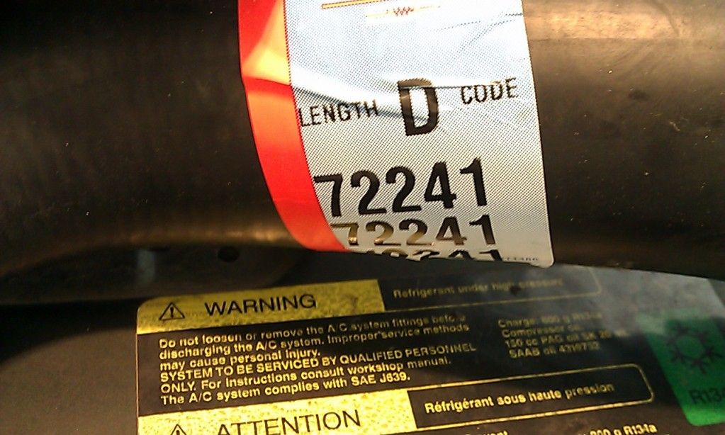

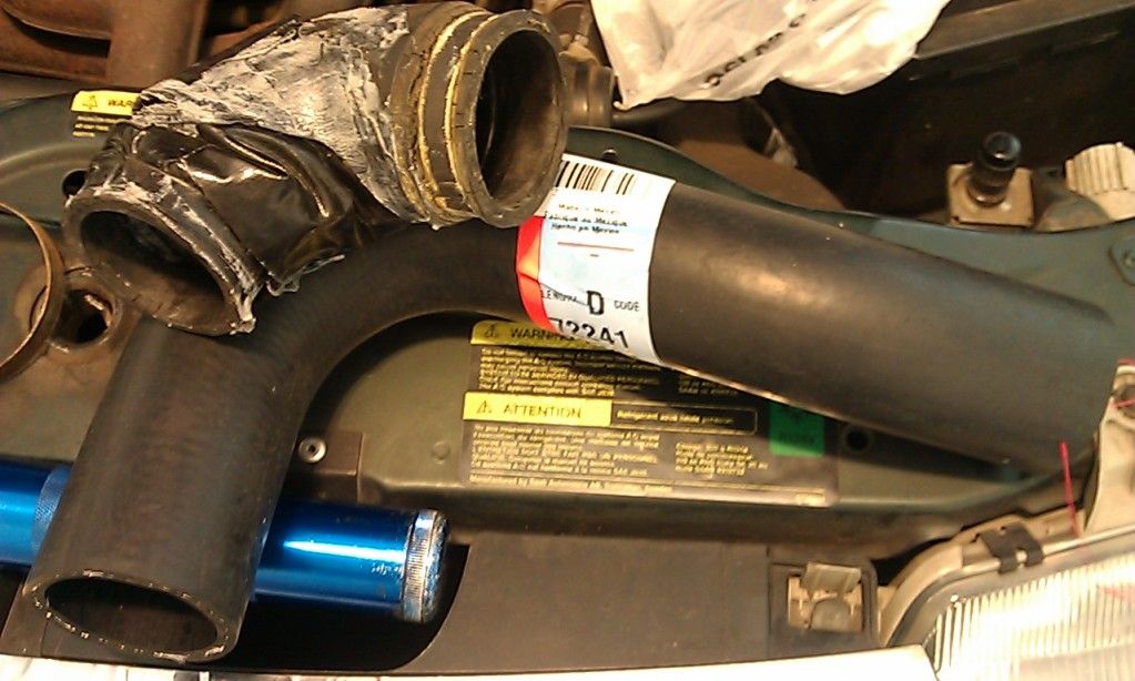

This may help someone in the future that has this problem.
This is the hot side elbow right at the IC, (lower hose). Mine was blown when I got the car so I used some gorilla tape to see if it would hold and to see if it was actually the cars problem. I had always though of taking it off and matching it up to a rad hose for a quick fix, but it held so well I figured to leave it. Finally today when I was running the car it blew. So I went to Advance and for $19 and two cuts, problem solved.
