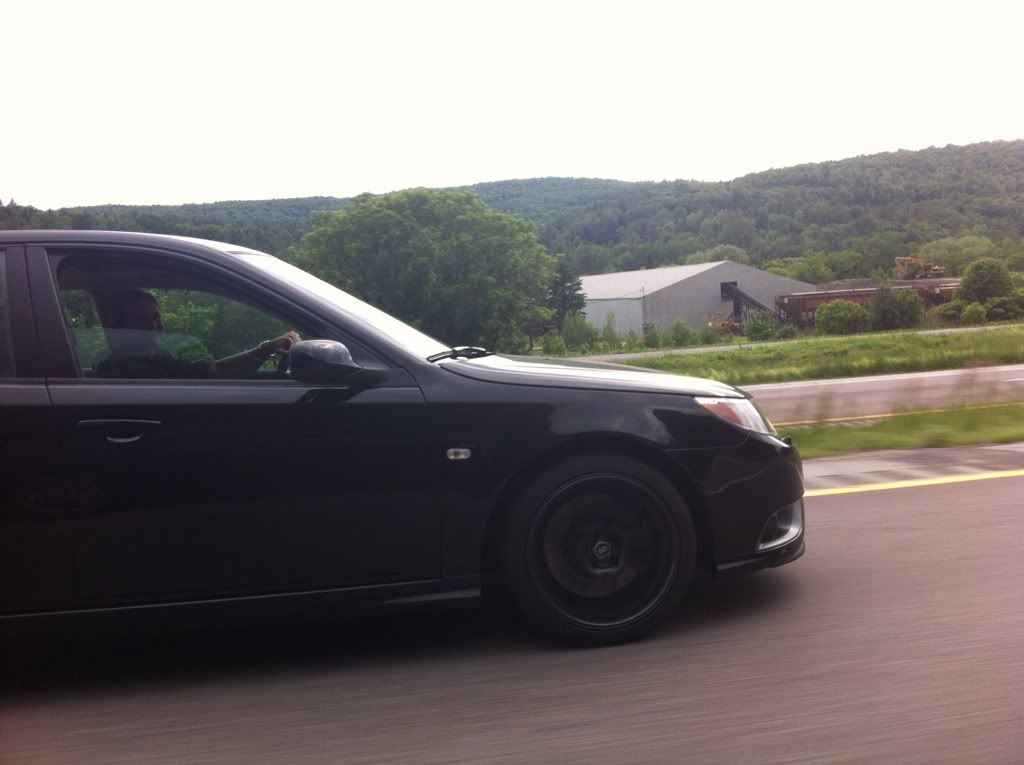

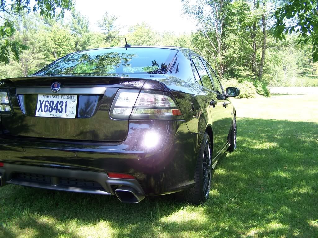

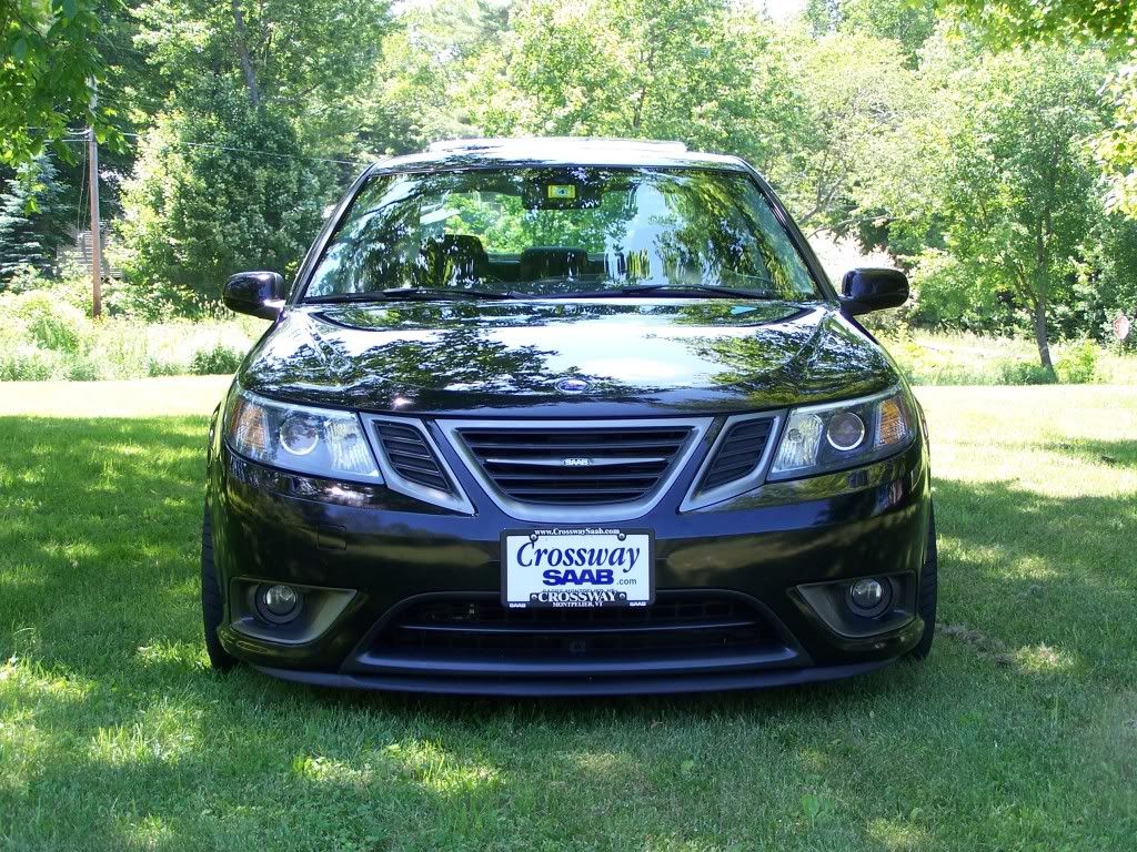

I got a Turbo X a few weeks back and I already have the itch to start playing with it. I had quite a bit into my Vector but never really made a build thread. So, Here goes nothing...
Turbo X - 49K Miles
When I picked it up I swapped the Turbo X wheels with my Enkie EKM3s and then shot up to VTuner. I know most of you love the TX wheels.. I personally don't, hence why I swapped them.
Got a fresh coat of wax on it today and got her looking real nice. Current mods are:
VTuner Stage 0 Rev. 2
15mm Eibach Spacers
18x8 Enkie EKM3
I'll check back in soon when I do some more ;ol;:cheesy:

looking good! glad to see you ditched the stock rims, man those things r hate them or love them, and i hate them lol
4,509 Posts
hated wheels good choice on the new ones, neeeeeds dropppp holy mother of wheel gap
622 Posts
3rd needs moooore low.. other than that I like those rims. SLAM IT.
Also... do you really need a front license plate.. I hate front license plates. your girl is to pretty to wear a bandaid..
2,225 Posts
Love that ride height and wheel gap. It is XWD after all, so any chance of raising it a bit further! Think everyone is so over lowered cars now ;ol;

Haha yea I didn't even think to take off the front plate! Stupid! I agree it needs to be a bit lower. I'm also running 225/40s which don't help my cause haha. It's just unfortunate that there aren't a lot of suspension options for the TX. It's probably something I'll do towards the end.. Unless I can find me a set of Hirsch springs..
I think first up is painting the calipers. I'm thinking yellow. Next I'd love 35% tint all around. Just sucks that NH law says you can't tint the front windows at all, and I hate the the look of the back tinted and the front not. I may be able to get away with 35% all around but I'm hesitant..
