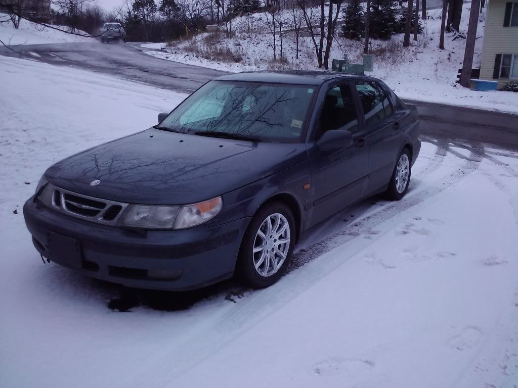

I have a 99 9-5 SE 2.3T Auto. I drive this car as a fun daily driver when I'm not running around town in my dragster. I have a serious addiction to modding my cars and this is my next victim.
I bought the car for $600 from some people who didn't know how to diagnose a rolled out turbo. I quickly replaced the stock garret turbo with a TD04HL-15T 6cm^2. Then came the cold air intake mod similar to the GS one that they sell for $80. I just fabbed up a full 3' exhaust for it. A Summit Racing bullet style muffler sits where the old resonator used to sit and a Flowmaster Super 44 is towards the rear. At idle, the car has a very distinct turbo whine mixed in with a heavy gurgle. The car sounds great at high rpms without sounding like a ricer. My forge motorsports bypass valve came in today and that made a big difference in higher rpm performance.

Nice car there Maritier, gerat find I would love to find one like that I gotta keep an eye out.
