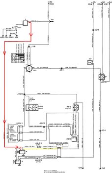

There are two leads to the starter/solenoid assembly. One is a big red one that connects to the battery positive and is always hot. The other one, is a little thin yellow lead that only sees voltage when the ignition switch is in the START position. That is the control side of the system. Without 12 volts on that wire, you can have all the voltage in the world on the big red cable but the starter motor will never crank.
Depending on the model year involved (and which version of anti-theft system you have), there may be 2-3 components required to get power from the ignition switch and out to terminal 50 on the solenoid. Also the gear shift interlock is in that circuit.
Try running a temporary jumper directly from the battery positive to the 50 terminal on the solenoid. Doing just that quick, simple test will tell you a lot about what the problem is. If the starter cranks, the yellow lead is the problem. If it still doesn't crank, look closely at both the battery cables.
