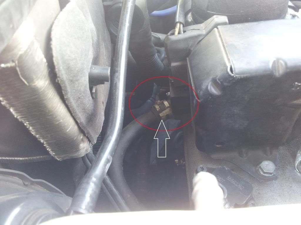

If you are talking about the vacuum line behind the TB, may I ask why you are trying to replace it?
I have had this issue for a long time and corrected it as pictures below. The first part of the that vacuum line is probe to leaks and it attached to the other part of the vacuum line which has metal kinda line inside and very tough to leak.
See pictures of what I have done.. no more problem.

Interesting Approach
Thank you Ashiq, and yes, that's the line that rotted out at the throttle body nipple. Your solution is a bit more elaborate than what I ended up doing...which is described in this thread:
http://www.saabcentral.com/forums/showthread.php?t=517441
But it's accomplishing the same thing. I'd like to replace it just as I intend and expect to eventually replace all the rubber lines in the engine bay. These engines run hot! Thanks for the pics. I've got to get up to speed on adding photos. I'm behind the tech curve on that.
