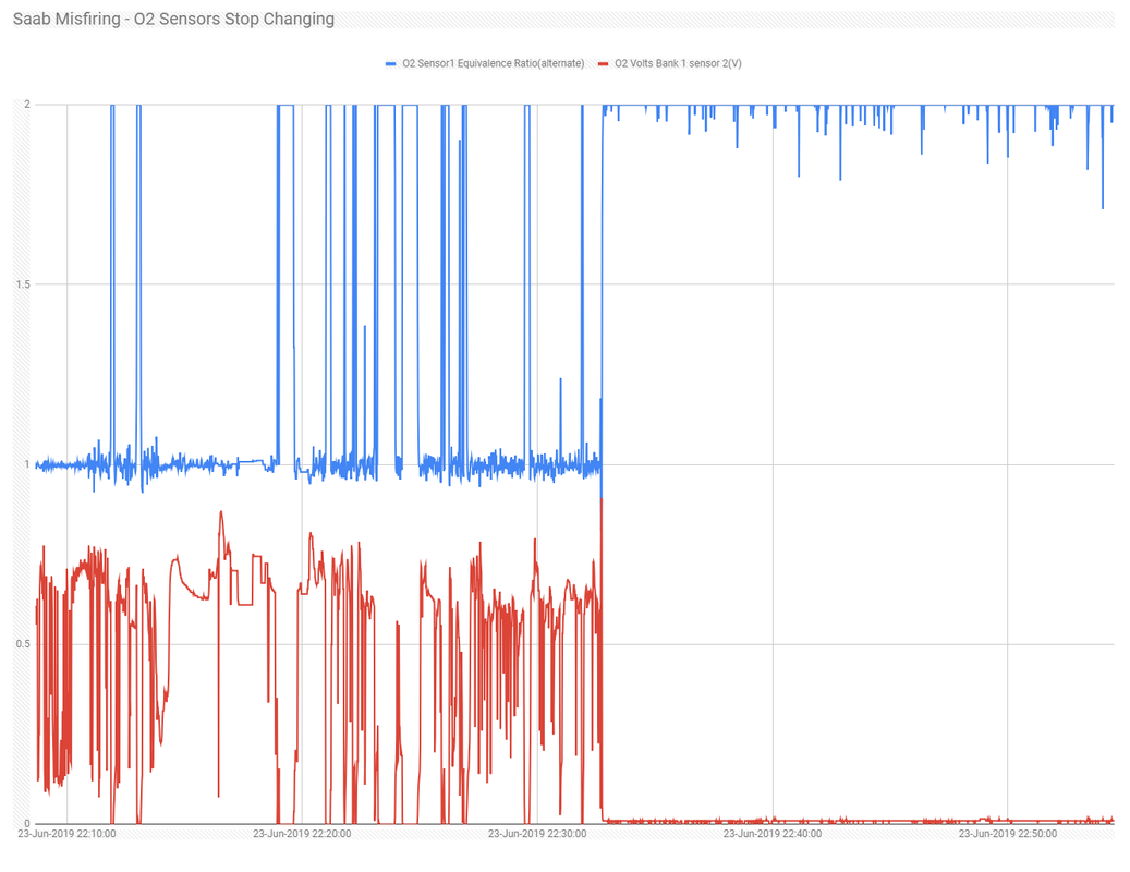

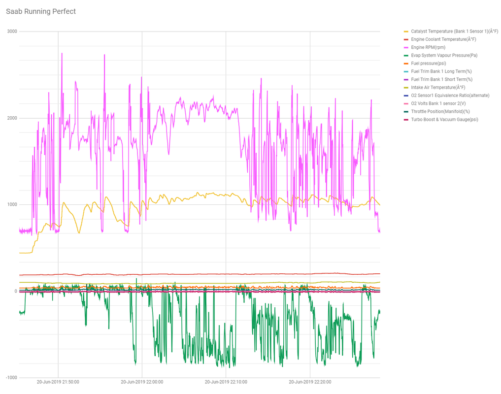

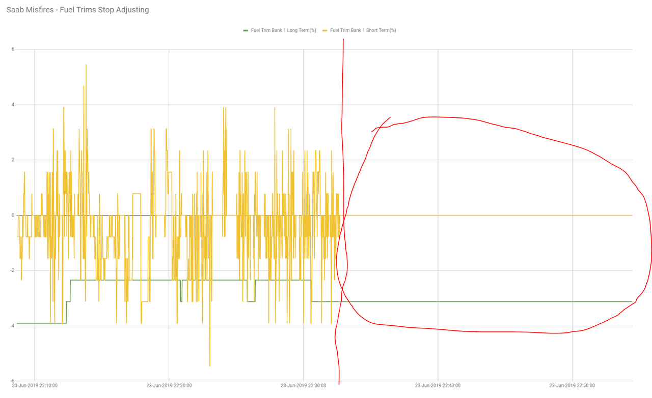

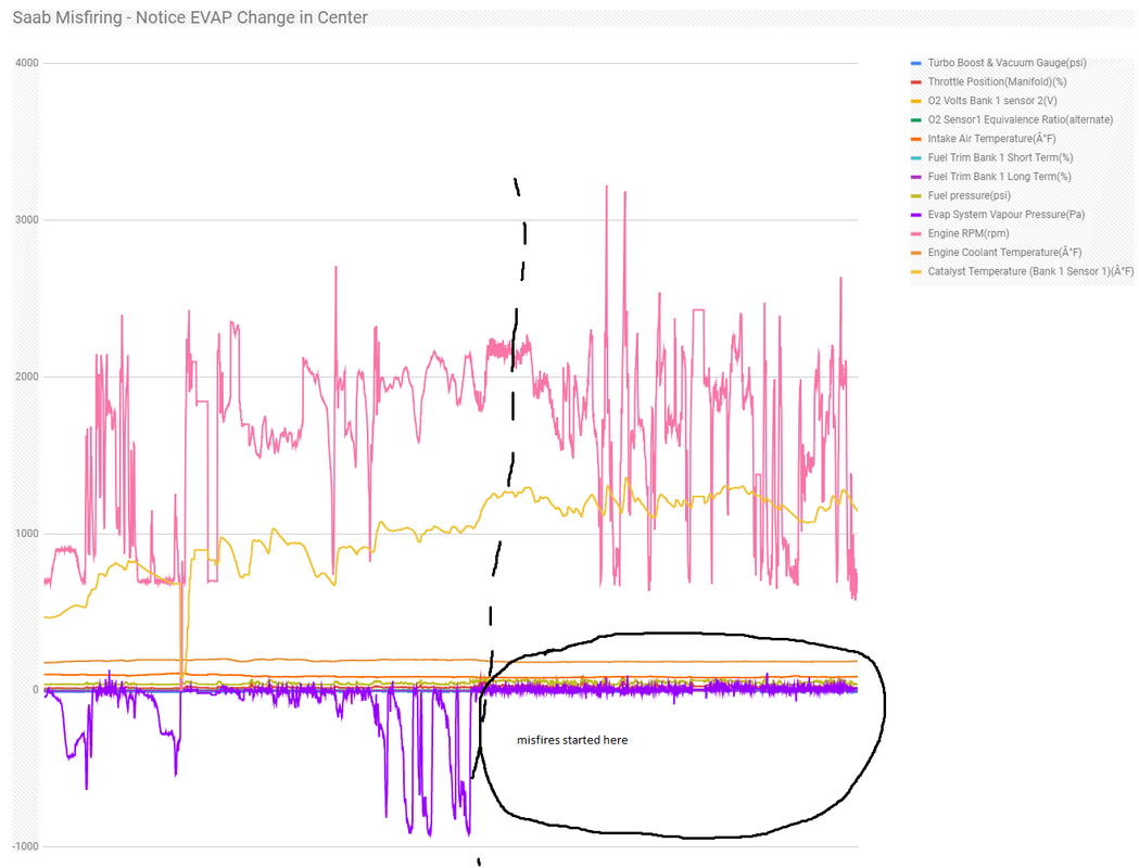

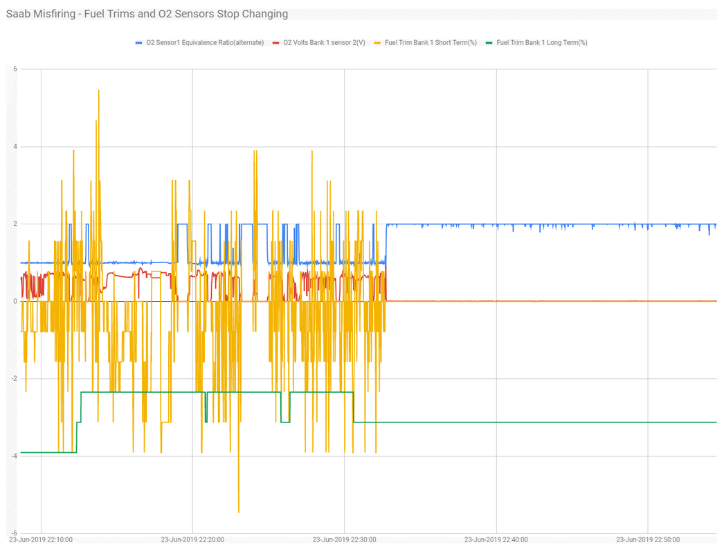

I downloaded and plotted my good and bad rides from Torque Pro to examine (See attached). When the misfires happened on the highway, torque stopped showing changes to long and short term fuel trim. The o2 sensors seemed to also flat line and the evap was no longer fluctuating like when the car was running normal.
I used torque for my logging because it was much easier to do with the tablet and bluetooth dongle. The car stopped misfiring for over a week and then just did again.
The three times I have disconnected the coils and plugs and ecu (ME9), afterwards the car has worked normally meaning no misfires. Which makes me believe the issue is electronic but that is just me thinking out loud. After everything that happened and looking at the torque data seems like it could be my 02 sensors and/or something with the evap because data stops changing immediately after the misfires. :roll:

Evap an fuel trims might be normal to shut during a misfire condition(i will have to look at WIS), however O2 should operate normal for sure unless there is smthn wrong with the app, but if they r flat down, that could be ur issue (lean running)
Im sorry, the data is too blurry i cant see nthn .. pm plz
Hush thanks for pointing this out, the forum shrunk my photos. I just put them on another host. Answers to your question below.
