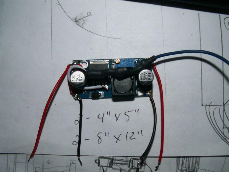

Hi there,
I replaced the voltage regulator with a LM2596S-based regulator you find tons of at ebay. These regulators have some advantages:
- very low margin needed, so the regulator works down to 6,xx Volts and Tech2 survives engine start on my car.
- the LM2596 has an On/Off-pin, to get the same behavior as the original tech2 to power on and off with the power button. Unfortunately the high/low-logic is inverse, so that I had to add a transistor (BC547) and two resistors (4.7k and 1 kOhm) to integrate it correctly. The pin 5 of the regulator had to be lifted from the board to solder a wire to it.
Enclosed find some pictures. The regulator is sticked to the board with some very adhesive double sided adhesive tape... and trimmed to 5V before
Works very fine.

I struggled also a bit with that. I had to turn the brass screw on the trim poti maybe 10-20 times counterclockwise to bring the poti to a working range. At start just screwing half turn left or right changed nothing.
Good luck!

Yes, I used an external power supply, and checked the output voltage with a multimeter. But you could also use the power supply provided with the Tech2.

An original Tech2 under normal battery conditions does not reboot during engine start. This is related to the voltage regulator on board and the margin it needs to maintain 5V output to the Tech2 board. The original voltage regulator can keep this voltage with a dropped battery voltage down to 7V or even lower.
This is not related to the VCI hardware.

I thought I had a stack of 4.7 OHM resistors to get this mod done this weekend, only to find out I didn't. 47, 4.7K, but no 4.7.

Good that you replied. I meant 4.7 kOhm and 1 kOhm, but I am quite sure that both 1kOhm will also work.
