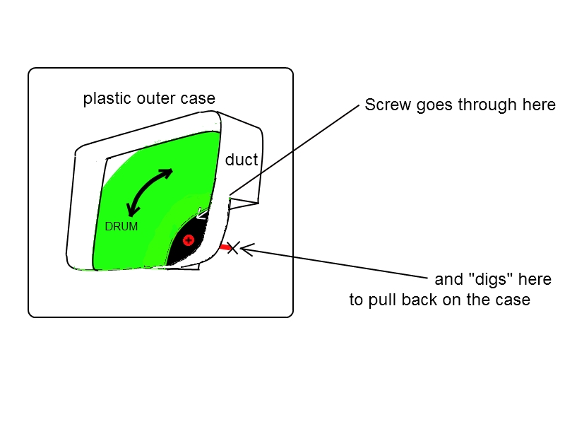

LOL...I came in here to warn you not to put a screw in there, but been beat:-D Just came back from working on it. Now if you do PULL on the part behind which the temp control lever is it DOES make it easy to turn the drum. So I'm planning to drill a hole in that tab in which the screw is shown in the diagram and than use a T-hook and some wire to pull ot a bit to the pass side. that should free it up enough for the drum to move without having to break the toilet paper holder. Thats a nice project for tomorrow morning.P.s. my pics are dark...yours are much better, so I'm not even going to bother posting them.

Any chance that the screw fix was intended for the driver's side of the box?
