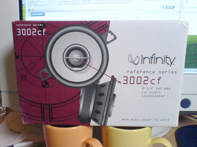

I'm looking to upgrade the dash mounted 3.5" speakers and, after a little research, I have whittled my choice down to either:
Infinity 3002cf
Boston Acoustic S35
Does anyone have any experience with either of these speakers, or these two manufacturers?
BTW: I have the extra amp and door speakers fitted.

I just picked up a pair of Infinities on eBay for a song. Look around an there are some good bargains to be found. I bought a pair of eclipse 3-1/2s for my daughter's 900 that sound good too.
I went with the Infinities because it is easy to upgrade the caps. I'm going to upgrade the stock caps with some better quality audio film caps whenever the fall maintenance work is finished.
