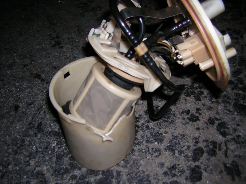

a while back i posted about how i kept blowing fuel pump fuses. thank you for your help. i finally found out what was causing it, before i gave up and took it to a shop. we checked ALL the wiring from the fuse to the ground and it all checked out. one night later i decided to go and make me a little 'access panel' to the fuel pump. as seen here:

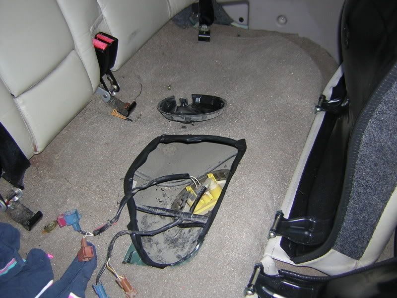

from there i could easily take out the fuel pump assembly, saving myself 3 hours of extra work. i noticed immediatly that something was not right. the pump assembly would not come out. well here's why:
the assembly was completely smashed. when i took a closer look, i noticed that a black and white wire were cut, most likely by the metal strips connecting the top to the pump housing. there was why the fuses kept going. i was really lucky that it didn't spark while it was in the tank. notice the condition of the housig. i think that the previous owner DIY'd the fuel pump insert and man-handled the assembly back in.

how did you get the fuel pump out form the top?? i was under the impression that the only way to get to it was to drop that tank. this REALLY intestes me cause im gonna have to do this like any day now... and by any day i mean it quit two weeks ago, and i've been driving around my other car that im trying to sell. and i kinda need to sell that one to fix this one. haha and if i can do the install from the top. dear god that is the best news i've gotten all month! haha

if you're gonna cut an access panel, like i did, use tin shears. you'd have to be really careful using a grinder (cause you're right above the fuel tank) and a sawsawl (cause you could damage wire or fuellines). when i was done i put electrical tape around the edges so i wouldn't get cut trying to pull the pump out. once i'm done i'll waterproof it, i just want my damn car to run. i miss playing with her.

Great photos, best yet !! This must be part of the ongoing repair manual...
Why not cut the hole in the floor, IMO, this beats by far either dropping the tank or worse yet, paying a "pro" many hundreds of $$$$ to do this.
BTW, if I were still turning wrenches for money, I would use the "making an access door" route, but I would have to discuss this with the customer, for his approval..

I did the same cutout when I replaced mine. I think it is better than dropping the tank too. For the rough edges that remain after the cut, paint them with some undercoating or primer and then use a couple feet of 3/8" pvc hose with a length-wise cut to slide over the edge. I stuffed some fiberglass insulation down in the hole to deaden any road noise.

So true Earthworm! It is a real shame that Saab did not make this door out of the factory as they did in the past. I just had to buck up over $600 for this very same repair, because the tank straps were shot and needed to be replaced. You are right about it being a PITA too my Pro was not too thrilled with the job as i had a FULL tank of gas at the time which made it even worse.
It looks like you did an excellent job Leary how is the waterproofing holding up? that was my biggest concern about messing with the cut out.

it's funny that this thread resurfaced because last week my pump motor went bad. i went to autozone and bought a new motor for 99$ (it is a walbro) and put it in. because i made my "access panel" the job only took 2hrs. the hardest parts being the removal of the lines from the sending unit and wiggling the pump assembly out of the hole.
you will notice your pump motor is going bad when it gets louder. mine was chewing itself apart. inside the strainer was a bunch of metal shavings. needless to say, i replaced the filter as well.
a good thing to get once you've done this job is the factory gm metal clip that screws into the sending unit and holds the check valves and lines down. the yellow 'clips' that hold the lines down always break. a pressure line coming disconnected while you are driving is a scary thing. it is like 5 bucks and you can get them from www.genuinesaab.com.
overall i highly reccomend making said access panel if you plan on replacing your pump. it really saves a lot of work. small, asemetrical fuel tanks can be harder to remove then larger, more rectangular tanks.

Its really easy, I had to check the wifes Saabs fuel pump and it took me 15 mins to get it out including cutting the floor.
I used a nibbler as used for cutting out sunroofs in an air drill, that took 2-3 mins max.
To get the lock ring out I used very large water pump pliers with the jaws at their widest setting and used them to rotate the lock ring, the hardest part was getting the pump assy to the right postion to with draw it, as the tank was full and I couldn't see past the fuel to see where pump was.
