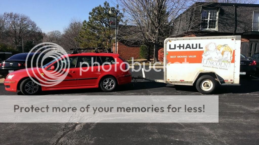

Installed one last week (was a snap) and towed a loaded 5x8 uhaul trailer on Saturday. Using a fuse tap off #8 was a fantastic suggestion; learn something new every day.:cool:
