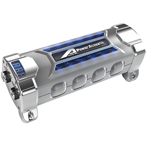

Finally got my I Pod working with my Stereo
And iam putting this in Tomorrow
