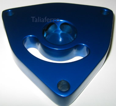

There is a way to convert the stock valve to atmosphere dump 8) I have not had time to test it but have a prototype part on hand. A far more elegant solution. :wink: The ports from the central hole connect to atmosphere to allow dump and therefore make the really cool sound.
Nick T

Whoa!
I want one.
What's the price like?

Hey, Nick :P
I'll be the first one to buy it from you.. :wink:
and When will you have it for sale? :P
