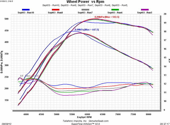

The drag car is tuned close to LBT on those runs. Ignition timing more or less just close. No time to map MBT. (After lots of work before it was close, A couple runs 2 deg apart confirmed.) For whatever reason this setup is much happier on the lean side compared to other motors and other makes on E85 at this specific power. Would make the same power at lambda .9 too..
Here are some of the session runs with different boost control. Just on the spring for the bulk there. #10 is with T7 valve and bit pulled out to get the peak down. But full bypass on spool to get it going. Goal here was finding the right fuel. Pretty consistent though. Left off boost and lots of other data but you get the idea.
Maybe now its time to actually build the car close to what I would do for a paying customer...

That's a pretty significant difference in spool.. interesting find.

Thats a pretty sweet afr plot-very neat!
Awesome job!
