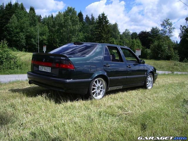

Default Showing off my 9000 Aero Stage 8˝
A little information about the engine.
¤ Saab Viggen Cover (not mounted on pics)
¤ Holset HX-40 turbo
¤ Intercooler bxhxd 600x300x7,6
¤ 38mm Tial WasteGate, (1bar spring)
¤ 92mm JE Pistons
¤ 276/10,4 Race cam
¤ Verdi shafts
¤ B206 block (Saab 900), Drilled to 2,4Liter (No balance shafts = 10kg lighter)
¤ 3" Pressure tube, (not mounted on the photos)
¤ 2kg Lighter 9000 Aero Flywheel
¤ Siemens Deka 630cc injectors
¤ Cylinderhead job done by Mike Billet. (proffessional race ported)
¤ TrollSpeed valvesprings
¤ GReedy Dump
¤ Tubular exhaust manifold
¤ 4 Puck Solid Sinter with sachs 600nm presure plate
¤ 3.8bar fuelpressure from audi RS2.
¤ 3 Bars Mapsensor
¤ Walbro 255L fuelpump
¤ BIG Green cutton filter
¤ 3" Downpipe + all the way back
= Aprox 520hp
Gearbox: Housing from an 9000aero -98 with
*Quaife Limited slip Diffential
Quaife straight cut gear kit 6 speed
will tolerate 1000hp!
"Have under many years been driven by worlds fastest saab 900 (Robert uhr 10.42/231km/h)
With more than 100 of 402m(1mile) races has been done without any transmission malfunction at all!
The power on the test cars, has been from 600-800hp."
PS. Im from sweden so you have to excuse my spelling.

My lord that is a huge Turbo. I like the car!

Wow, very very nice. 9k with huge power and unbreakable gearbox, does this mean the drive shafts are failing on you?
Post a video of it being used in anger sometime.

Looks excellent! I recall maybe seeing a video of this car on youtube? The username "Hammarslag" looks familiar to me for some reason!
Thanks for showing off the car, and your English/spelling is just fine. In fact, its probably better than most Americans' spelling.

That is absolutely beautiful Oh the possibilities! Good luck and have fun.

That car is insane!!!
i think i should move to sweden!

Thats great! Really nice.
How do you manage to get full boost so early? Especially with those cams?
I get full boost at 3500rpm with my GT3071r 0.86 on T5 cams, tubular header.
Also - those are one of the few wheels that look good on the 9k ( to me anyway) .... what are they?
I dont know, Trollspeed (Frank @ former SQR racing) is werry talented in optimizing Tronic systems, if i remember right he told me that they use aggressive ignition to make the engine produce more exhaust = makes the turbine spoolup faster.
Also the engine is drilled to 2,4L, that makes a small diffrence to.
- Now the car is at trollspeed again (trollspeed.se) for finetuning for those racing shafts ect, will see how they effect the spoolup.
Will get the car back by whensday, will post more info then
