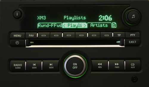

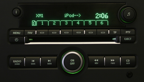

Just found this http://www.dension4u.de/shop/product...3ad660445141fb
iPod CarKit for Saab/ Cadillac MJ2008 iPAC GM3H
The iPAC-GM3 interface is used specifically for the 2006-2007 GM LAN 29-bit Databus vehicles. The iPAC-GM3 has three modes of operation; Advanced, Manual, and Auxiliary Input. With a press of a button, you can switch between iPod, auxiliary and XM (if equipped) Advanced mode allows full control over the iPod's extensive menu with the factory radio or steering wheel controls (if equipped) while the iPods text is displayed on the factory radio. Manual mode allows you to control the iPod from the iPods click wheel controls. Both modes provide charging to the iPod while connected to the iPAC-GM3.
The iPod-connection is affected by a dock cable (in scope of delivery). The adapter is compatible to all iPod of the 3. / 4. and 5. Generation, photo and video, mini, nano I and nano II.
ID3 Tag information
iPod playlist selection on the radio
iPod menu in the radio
Now for a bit more research before I'm sure I've found the answer for complete integration of Ipod into the new audio system.
Just thought I'd share.

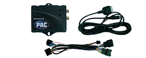

Right, here goes, I'll try to summarise what I've found out so far.
The piece of kit that I posted in post 1, is manufactured by a company called PAC (Pacific Accessory Corporation). The link I posted is the only link I have been able to find that says this will work with the 2007 Saab.
PAC's own website do not list compatability with Saab, but they do not say it is not compatible either.
From PAC website
Part Number: IPAC-GM3 </SPAN>The iPAC-GM3 interface is used specifically for the 2006-2007 GM LAN 29-bit Databus vehicles. Designed for Video, Generation 3, 4, Mini, and Nano iPods. With a press of a button, you can switch between iPod, auxiliary and XM (if equipped). The iPAC-GM3 works with vehicles that have navigation-equipped radios, non-navigation radios, and vehicles equipped with XM satellite radio and CD changers.• Three Modes of Operation (Advanced, Manual, Auxiliary input)
• Full control of iPod through factory radio buttons:
• Allows browsing by: Playlist, Artist, Genre, and Album
• Displays iPod text on the factory radio's display
• Control the iPod directly through iPod’s click wheel controls
• 1 Auxiliary Input allows an external audio device to be connected to your factory stereo
• Works with XM Satellite radio (if equipped)
• 10 ft iPod cable included
• Optional 17 ft iPod cable (GM3POD17)
Required Connection Harness Sold Separately
GM3H: Vehicles without XM radio (connection made behind the original radio)
GM3XM: Vehicles with XM radio (connection made at the factroy XM tuner) Compatible Vehicles: Chevrolet: Tahoe 2007, Suburban 2007, Avalanche 2007, Impala 2006-2007, Monte Carlo 2006-2007 Silverado (non-classic) 2007 GMC: Yukon 2007, Yukon Denali 2007, Sierra (non-classic) 2007 Cadillac: Escalade (including ESV and EXT) 2007 Buick: Lucerne 2006-2007Latest Revision: 5v40Instructions: ipac-gm3_
Sorry will finish this later, work calls, but I'm guessing that 100$ will cover the unit, then the cable will be extra, but $100+ for the cable seems a bit steep still.

Right I'm back now, 'til something else breaks down anyway.
The Pac website installation guide says that the head unit must have a "CAT" buuton for the system to work, I believe this buttom is for the US market satellite radio so you can choose which category/genre you listen to.
The UK (and Euro) radios have a "PTY" button in this location, but the link I posted shows it working on a radio with the "PTY" button, though it doesn't say which car this is in.
Basically, I have no confirmation that this will definitely work in the Saab, but I am seriously tempted to get one anyway, (and an IPOD) just so that I can test it, and hopefully have a fully integrated control system.
If I do decide to, I will post up my findings.

My 2007 USA-version radio has the PTY button and does NOT have a CAT button. So according to the post above, this PAC kit will not work with it then??
I don't recall what PTY is for, but I seem to remember that my owner's manual says that it is non-functional in the US market. Maybe I'm wrong, but I think that's what I read.
I think an email to PAC is in order.

This is from a 2006 Pontiac Solstice:
It has the CAT button so I can think of 2 possibilities for the CAT/PTY variation.
1. Dependant on XM installation : CAT with XM, PTY without
or
2. Dependant on manufacturer : PTY on Saab, CAT on other GM makes.
Don't know, just guessing.
I have emailed the company in my first post to see if they can confirm it works in a Saab, so hopefully I will here back within a few days or so.
Steve.
or
Steve.
Not the case. My car has integrated XM, but still has the PTY button.
I'm interested to hear what they say. Let us know! Thanks!!
