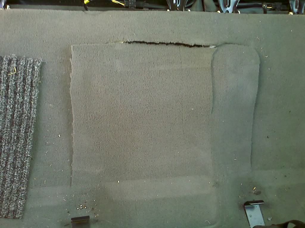

3) To gain access to the fuel pump without dropping the gas tank, you may cut the carpet and the access hole with a good pair of scissors and tin snips. Here's a shot of what I started with:

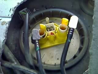

4) Remove the plastic cover that protects the fuel pump wiring block and check valves from dust and water. Just pry it up with the widest flat blade screwdriver you have. The cover is rather wimpy but it'll pry up ok.
5) Disconnect the pump wire harness. Using a small flat screw driver, insert the screw driver flat between the harness connector and the yellow tabs beneath the 'clip' part of the tap. Gently rotate the screw driver so as to pry the yellow tab holders away from the block connector. Do this on both sides while pulling the connector up enough to keep the tab you are prying from dropping back into place. Then take out the block connector once both tabs are 'free' from slipping back into place. Be gentle with the tabs because breaking them, while not the end of the world, isn't a great thing. Just rotate the screw driver enough to make room for the connector to move up.
6) With the harness block connector out of the way, spray some WD-40 (or other reasonable lubricant) down into the plastic 'nests' in which the plastic check valves are (likely tightly) placed. Each check valve has two o-rings:

Cutting the access is done carefully, very carefully; but ,I think if tin snips are used, it would be nigh impossible to mess up...

I would recommend removing the screw completely from the yellow plastic tab retainer.
